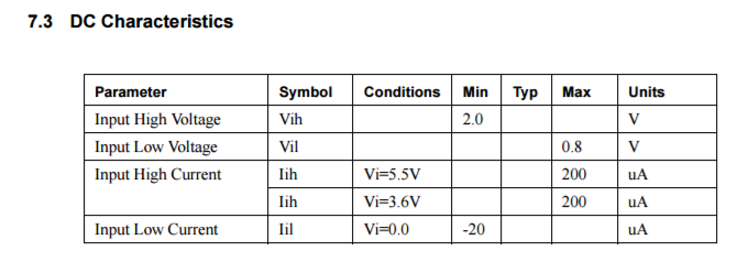

  • I would recommend the AVC16T245. According to the RII specification, current draw can be as high as 200uA but the TXS and TXB translators can only provide up to 20uA of current when driving a logic high or low. The AVC16T245 can provide several mA of drive current and can meet the required clock frequency of 50MHz.

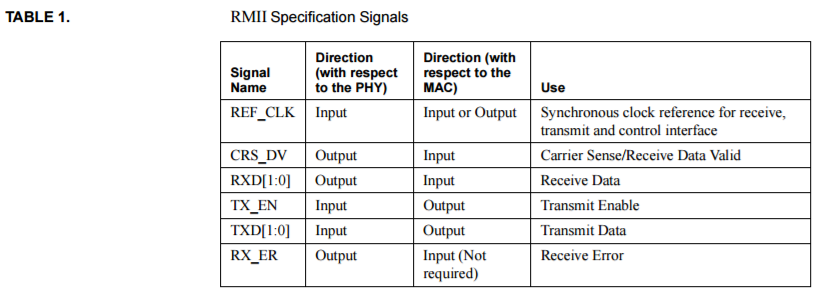

  • As far as I know, RMII uses five unidirectional signals in one direction, three signals in the other direction, and one bidirectional signal (MDIO). Is this correct?
    The SN74AVC16T245 requires that one direction is chosen for each group of eight bits, so it looks as if it is not possible to handle MDIO with it.
    If it is not possible for your microcontroller to set the MDIO direction manually, you need a level shifter with automatic direction sensing, i.e., a TXB/TXS device. (The automatic direction sensing requires that the signal can be driven with at least 2 mA.)
  • I think you are correct, there actually is a bidirectional signal. I was referring to this RMII Specification document. On page 4, the specification calls for 8 unidirectional signals but this does not include the bidirectional management signal.
    If the bidirectional MDIO line is included then the SN74AVC16T245 will not work. Would you be willing to use a solution that required more than one translator? I am hesitant to recommend an auto-direction translator due to this 200uA input high current spec, which will reduce the VOH of TXS and TXB translators.
  • Well, strictly speaking, using 1.8 V or 1.5 V is not covered by the RMII specification anyway. It's likely that for these devices (whatever they are), the actual input current is much lower than 200 µA.
  • RMII bus of device contains signals that listed below:
    RMII_REFCLK Input    Reference Clock input
    RMII_TXD0     Output Transmit Data output 0
    RMII_TXD1     Output Transmit Data output 1
    RMII_TXEN     Output Transmit Enable output
    RMII_CRSDV  Input     Carrier Sense/Receive Data Valid input
    RMII_RXD0     Input     Receive Data input 0
    RMII_RXD1     Input     Receive Data input 1
    And a MDIO interface for configuration. I will use TXS0102 for level shifting of MDIO. Data part of bus is bi-directional.
