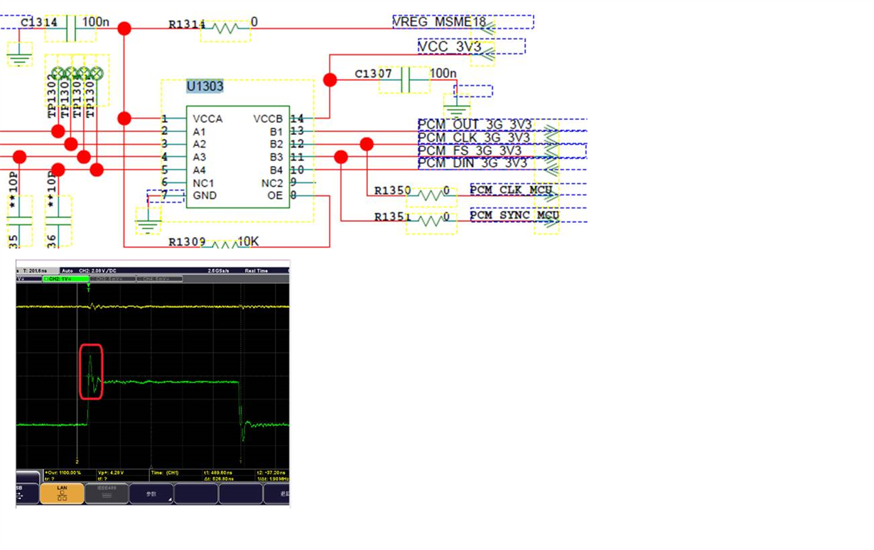

Hello
My customer's schematic is as below, VCCA is 1.8V and VCCB is 3.3V. There is a big overshoot voltage of pin A3, the time of overshoot is about 22ns, and the voltage is to 3V. What’s to result in this overshoot? Is there any risk of this overshoot voltage? I have suggested customer to put one small cap between pin A3 and GND and test the waveform again. thanks
