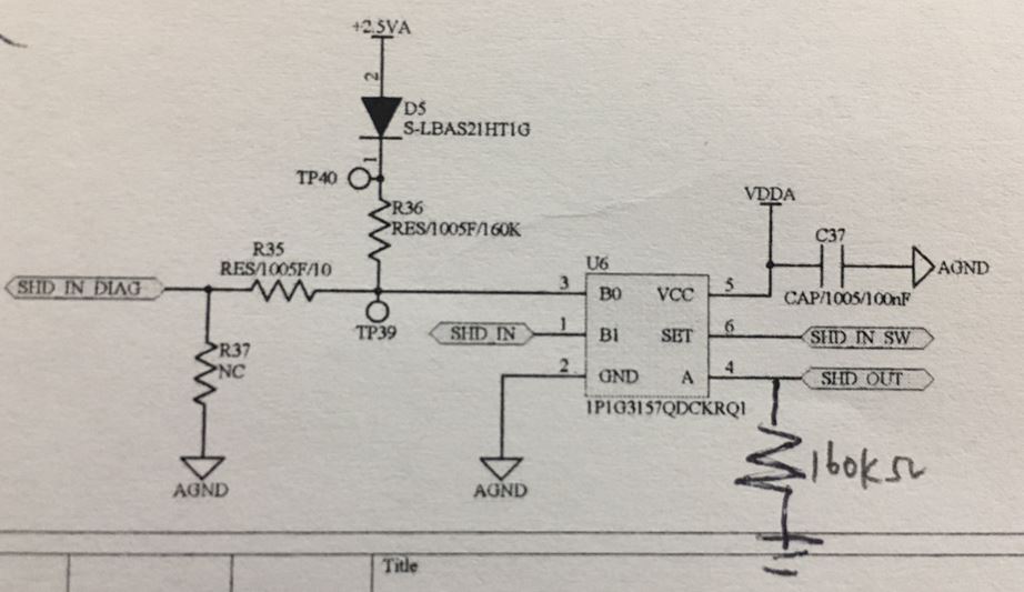

Hi Team,
Please review the SCH as attached.
I have one question.
The Vcc =5V, SET is 0V / 5V. A = 5V to 5.3V
SET=0V, B0 is turn-on at A=5V
SET=5V B1 is turon-on at A=5V. but A is changed to 5.2V then B0 is also is floating is 2V. Is this correct?
in D/S, A is max 5.5V.
Nate

  • When SET is high, B0 is not floating but at the voltage imposed by the pull-up resistor R36 and the diode. The voltage drop over the diode depends on the current through it, which depends on the load on SHD_IN_DIAG.
  • Hi Nate,
    I noticed that your question is about SN74LVC1G125-Q1, a buffer, but your schematic shows a 1:2 analog switch.  Can you clarify?
    I have redrawn your schematic to more clearly show what's going on:
    Can you tell me what is at each highlighted box?  From the sounds of it, there is likely a small current passing through the diode which, as Clemens said, is biasing the B0 port to ~2V (which is what you would expect if the diode were turned on, even slightly - that's a standard silicon diode with minimum forward voltage around 0.4V)
    As for the voltages - you are correct that you can apply up to 5.5V to the device -- if A goes up to 5.3V, that is no problem.
