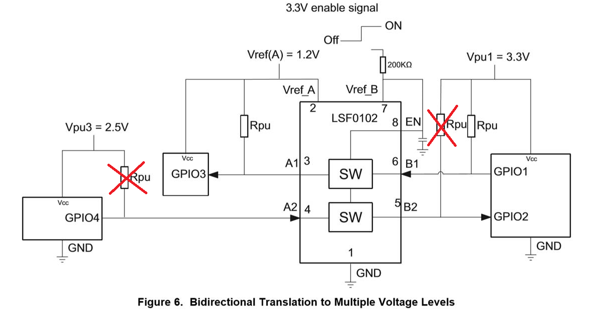

Hello Team,
With below setup for LSF0102, will B1 follows A1 to low when A1 changes to low level (0.3V)?
Channel 2 is not used and there is no pull-up resistor at A2 and B2.
Set pull-up resistors 300-ohm at both A1 and B1
Put 200k-ohm pull-up resistor to 3.3V at VrefB. VrefA connects to 1.8V directly.
Send 0.3V at A1, and monitor B1.
Below shows that no pull-up resistor at channel-2.
Will there be any problem for LSF0102 channel-1 to operate normally?
Thank you.
