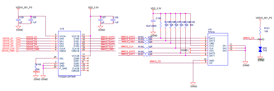

I already use a TXS02612 SDIO expander voltage-level translator for connecting of a SD Socket to a xilinx Zynq SoC to Shifting from 1.8V to 3.3V.
it almost works in 50mhz or 100mbps.
so right now I want to substitute it by a Bidirectional Level Shifter with SSOP or TSSOP packages?
I highly appreciated for any offers about a suitable substitution voltage level shifter :-)

    in one side, I have a xilinx Zynq7020 that it is a SoC chip consist of two Cortex-A9 processor and a ARTIX7 FPGA in one package.
    it has two SD peripherals that they work with 1.8V supply.
    I already connect one of them to a SD socket powered by 3.3V through a TXS02612.
    my SD peripheral works near to 50Mhz clock and 100mbps data transfer.
    I'm going to upgrade my hardware and I want to substitute TXS02612 with a voltage level shifter with a package for ease of soldering than TXS02612.
    my desire package is SSOP or TSSOP for the voltage level translator.
    u can find my already schematic for translating the voltage level between SoC chip and SD socket below:

  • Finding a level translator in a larger package isn't difficult - but finding one that does exactly the same job as the TXS02612 is.
    I can recommend switching to the LSF0108 for translation since it comes in TSSOP and supports high speed, bidirectional signals in most systems (low line capacitance is required) -- however this device is a simple translator, it won't do the switching functionality of the TXS02612 and it requires external pull-up resistors (at a minimum on the higher voltage side of each line).
    As for active vs passive translators, an 'active' translator will contain some kind of output driver, either push-pull or open-drain, and this driver will have an output current capability. 'Passive' translators will not supply any current of their own. The LSF device I recommended above is a 'passive' translator, so if your pull-up resistors generate 10mA when the circuit is driven low, then the device driving the line low must sink that current -- the LSF translator will not sink or source any current of its own.
    The TXS02612 works very similarly to the LSF0108, however it has more functionality built in. Both use a pass-FET clamping style translation method. The one-shot edge accelerators and other active circuitry in the TXS device doesn't change that it's a passive translator, however. The TXB0104 would be an example of an active translator if you'd like to see one.
