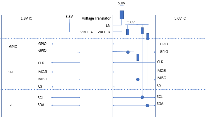

Let me confirm about below.
According to datasheet, there is following description in section 9.2.1.2.1 Bidirectional Translation
"the EN input must be connected to Vref_B"
It seems that EN pin should be connected to Vref_B in this device. But, if user want to control EN function and Vref_B separately, is it available ?
If you have the reason which EN pin should be connected to Vref_B, could you please tell me ?
(For instance, To avoid device is broken.)
