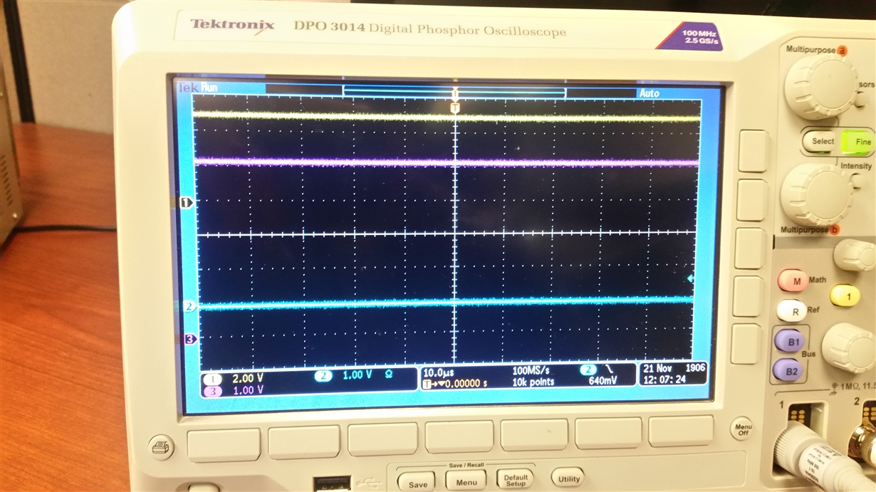

I am having issues with the multivabrator being stuck high for very long periods of time. It will trigger as expected when the function generator's output is set to on, but after the function generator is turned off the circuit remains high. Sometimes it will come down after a minute or so, but other times it will not switch back to low. I have attached a schematic of how the circuit is currently configured. I have tried switching the resistor and capacitor on Rext and C ext, but the same thing happens. I also added the load capacitor and resistor, but still the same results. Please let me know if you need any other information.

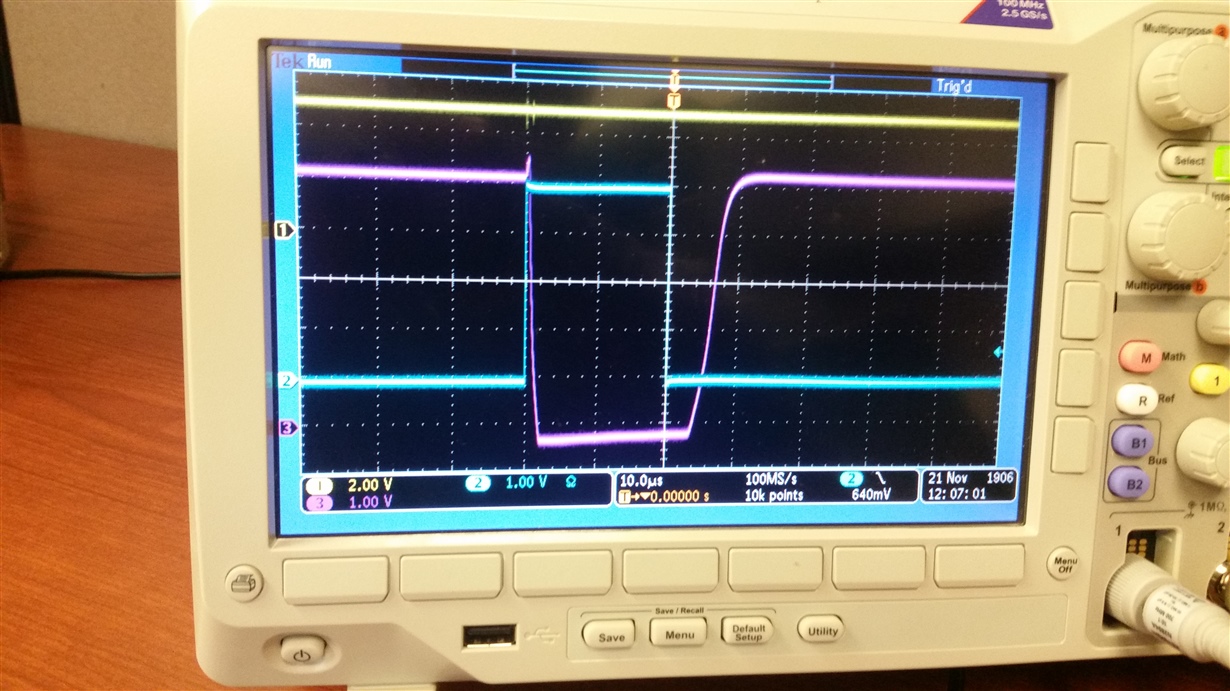

    I have attached a scope plots of both with the input on and the input off. The output of the multivabrator is on channel one. The output of the function generator is on channel two, while channel 3 is the input to the multivabrator after the mosfet. Please let me know if you need any other explanation.

  • Hello Al,
    The device will trigger based on the voltage seen at pin 7. If the output is staying high, this would seem to suggest that PIN7 is staying low/below the internal threshold for switching.
    Is Pin7 showing a low voltage at all times? The timing diagram in Figure 2 is a good reference for what Pin7 should look like to trigger the output.
    Please let me know what you see or if you find out any additional information.
    Michael
  • Michael,
    Thank you for your assistance. After checking the pin 7 I saw that it's state was never changing. This lead me to replacing the multivibrator again and it worked this time. I am not sure what happened with the first two, but I am happy to see it work.
