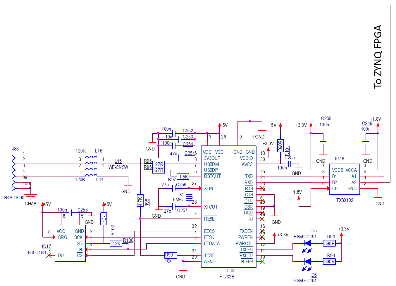

I have used the TXS0102 to level shift the TXD and RXD between a 1.8V FPGA and 3.3V UART/USB (FT232B).

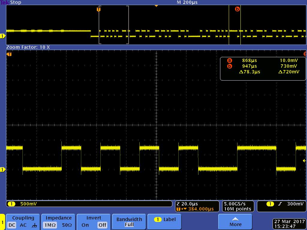

The signal (RXD) from the FPGA to the TXS0102 looks ok

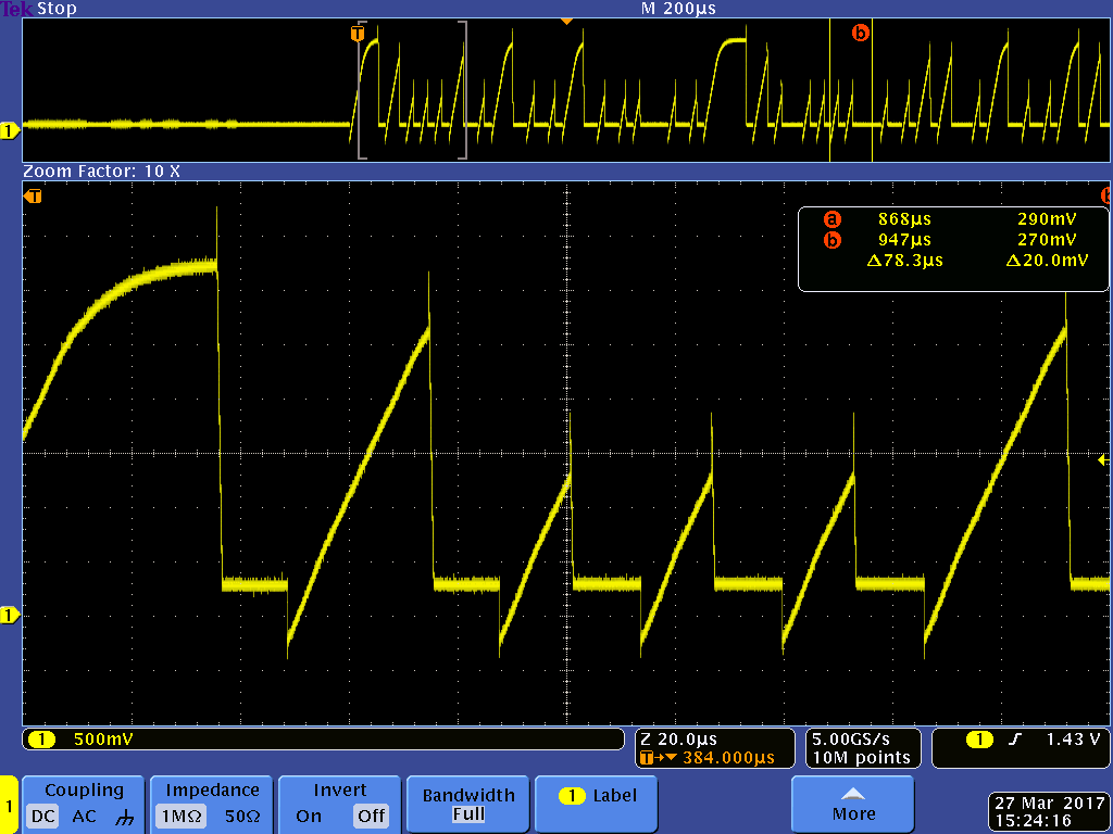

But the signal from TXS0102 to FT232B looks strange:
I will try to put a 1Kohm pull-up to the FT232-TXS0102 signal and hopefully that will produce the correct output.
I have two questions:
  1. It looks like the TXS0102 is inverting the signal. Is it supposed to do so?, or if not: What could be wrong?

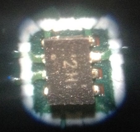

  2. It is difficult to see if the IC is mounted correctly. Maybe the PCB supplier has turned it 180 degrees. When looking at the picture, pin 1 is supposed to be in  the upper left corner. Can you confirm that it is positioned correct?

    How long are the traces between the TXS0102 and the FT232B? Have you tried a simple DC test? Could you try to apply a 1.8V DC signal to the input at see if it drives high at the output and apply a 0V DC signal to the input and see if it drives low at the output?
    It looks like the package is oriented correctly.

  • Perhaps the TXB0102 would be a better solution as it is designed for push-pull I/O. It is pin-for-pin compatible with the TXS0102..

    The reason for problem has been identified.
    The schematics was made for the DCT/DCU package, but when we did the PCB layout, we decided to use the DQE package.
    For some reason, pin numbers and functions are not the same for these different packages.
