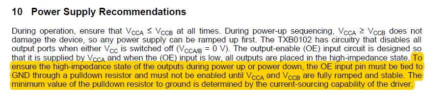

Hi, Team:
My customer wants to use TXB0102 to do 3.3V to 5V level shifting. By reading the datasheet, it looks strongly recommend us to make sure OE pin grounded during powering up. Customer won't like to use a extra GPIO to control the OE pin. What kind of leakage or risk will be present at the output if we only connect OE to Vcca during the system powering up?
Is it safe for us just connect OE pin directly to Vcca all the time?
