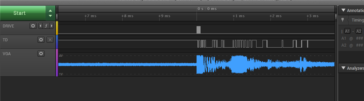

We're using the LM567CM/NOPB tone decoder. I have implemented on the bench fine working at 295kHz but in application the output is extremely noisy. We have used this chip successfully at lower frequencies of 40-75kHz. It should be able to lock onto frequencies up to 500kHz.
I've attached a picture of what's happening. The output TD should be locking on to the VGA signal, especially during 1ms - ~1.4ms but it isn't. I have tried several configurations for the capacitors but without any luck. All application notes are for frequencies below the 50kHz range (all that I have found anyway). In order to keep R1 within 1-10k range, I had to decrease C1-C3 to below the typical values - I'm working in the low nF ranges.

  • Hi Mehdi,
    External components are the same in the bench and in the system?
    Is there a chance you could share a schematic so we can take a quick look at component values?
    I think you're using some kind of real audio signal (several frequencies) for testing right? Have you tried a signal with a single frequency component with the device on the system?
    Is the capacitor at pin 1 at least twice the value of capacitor at pin 2?
    -Ivan Salazar
