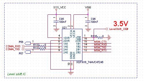

Team,
My customer is using SN74AVC4T245 as a level shift.
To minimize the current consumption, they pull #OE to high level.
but, the current still has 9mA. To remove SN74AVC4T245, he can get 50uA.
Is this normal to you? How he can improve his current consumption performance??
Here is there circuit (SYS_VCC=3.0V,V180=1.8V).
