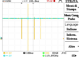

As the data were not recived form the mcu, I probed the lines and I noticed that the AT command is successfully sent to the TXS0102 from the 3.3v device, the AT command is successfully translated to 1.8v and sent to the radio module, the radio module responds to the command correctly at 1.8v and the 1.8v signal is NOT translated to 3.3v, so the mcu do not recive the data.

    Here is the oscilloscope with CH1 (yellow) the 3.3v line that goes from the mcu to the radio module and CH2 (blue) the 1.8v from the radio module to the mcu

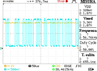

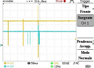

    in the next shot i moved the probe from the 1.8v side of the line that goes from the module to the mcu to the 3.3v side.

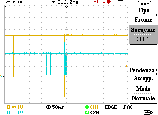

    Also, here is a closer look of the 1.8v signal from the radio module to the mcu

    It's likely that the added capacitance on the I/O lines is causing issues with the translation process. I have asked our translation expert to take a closer look at this post. While we wait on his response, can you grab a zoomed in scope shot of the translation? It's hard to tell what's happening on the edges from the above images. I'm looking for where the one-shot triggers, which should be within the first 30-100 ns after a rising edge (the scale up there is 50us; 500ns scale would probably show what we need to see)

    Also, i noticed that the radio module datasheet reports a "low" logic level voltage of 0 to 450mV, which is higer than the 0.15V stated in the TXS0102 datasheet.
    I noticed that the TXB0102 converter has the same exact footprint of the TXS0102, it has a low level treshold of 0.35*Vcca = 0.63V @1.8V Vcca and a rise/fall rate of 30ns/V instead of 10ns/V.
    Do you think that replacing the TXS0102 with a TXB0102 could help solving the problem?
    Andrea.
  • Nice pickup on the low voltage value of the radio module. It is definitely worth a shot since the scope capture you have is around 200mV or so I'd guess. One thing to look out for is the line/load capacitance you are trying to drive. The TXB is only designed to run with <70pF on it. The TXS is able to handle more than that and is better for higher capacitance driving. Also, one side benefit of the switch is that the TXB actually consumes ~510uA fewer than the TXS with the same reference voltage potentials you have in your setup.
