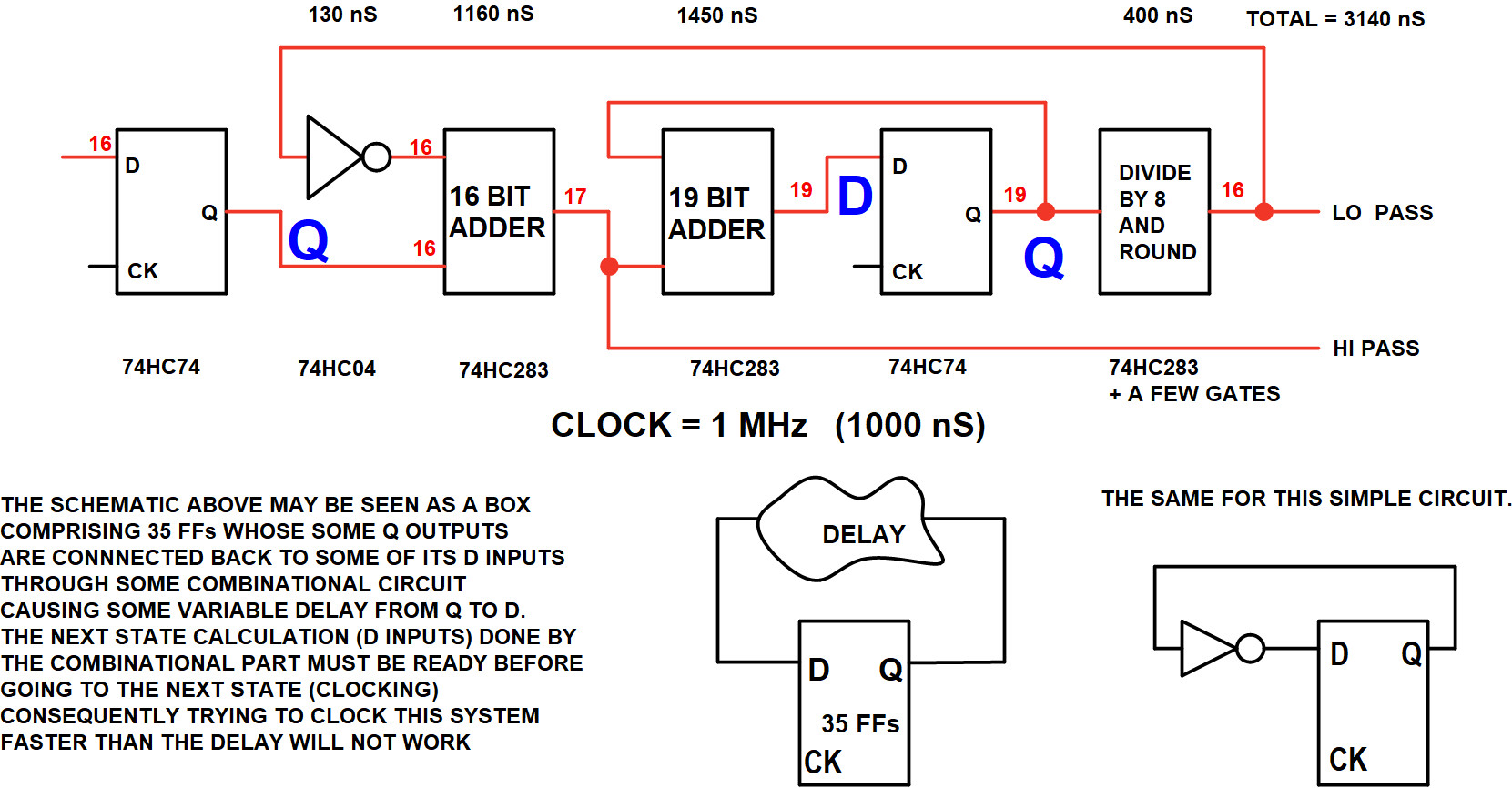

    Emrys and Michael, since I cannot attach a file in this forum, I send you a link to a schematic showing the issue.
    www.dropbox.com/.../Filter.jpg
    It is a 16 bit First Order Filter. In this JPEG schematic, lines in red are buses, numbers in red indicate bus width.
    In this simplified schematic, the inverter represents 16 inverters, the 16 bit adder is made from four 4-bit adders, etc.
    Of course, sixteen 74HC74 may be replaced by octal D FFs.
    Delay of each block is written above the block.
    This delay comes from TI's data sheets. (Operating temperature 85 degree, supply voltage 2V, 74HC devices.)
    Components used are named under each block. (Note: The inverter is required to build a substract function from the first adder.)
    The longest path is 3140 nS.
    System clock is 1 MHz, not so high a frequency. (This relatively low frequency is required somewhere else in the system, to process data at higher rates.)
    Is it possible to make this filter work in a 1 MHz system clock environment?
    Your comments and suggestions are welcome.

  • Hello Serge,
    Are you using a 2V supply? typically these devices are used with a higher supply which would significantly decrease any propagation delay.
    Furthermore you could use devices with much lower propagation delay such as the LVC family of devices, as opposed to the HC family you are using. With some of these functions we even have the AUC family which is optimized for high speed operation and can work well at 2V.

  • Emrys, thanks for replying. My initial question remains unanswered: is it possible that a path delay be longer than the clock period.
    Here is again the  example I used, using 74HC parts. (Delays shown for 85 degree, 2Volts)
    (I hope you can see it. I tried to paste from Word, it does not work: images are not transferred. So I attached a jpeg file.)
    I believe that this 74HC circuit cannot work at 1 MHz. Explanation in the image above.

  • Hello Serge,
    It is possible that the data path can be longer than the clock period, there will just be additional delay in propagation of the signal to wait for the additional period.
    If there is a glitch being generated from the output of a preceding logic device that cannot be removed and may clock the input of a D flip flop, a capacitor could be added at the output of the device to suppress this glitch. Since there will be additional capacitance on the line to suppress such a glitch, it would be recommended to use a schmitt trigger input device to be able to tolerate any slow edges.
    In this way, the glitch is removed into the schmitt trigger buffer, and it generates a clean fast rising edge input into the CLK of the flip flop which should only clock a single time because of this clean edge. A device such as the SN74LVC1G14 or SN74LVC1G17 would work.
    This should help to avoid any issues due to the glitch.
