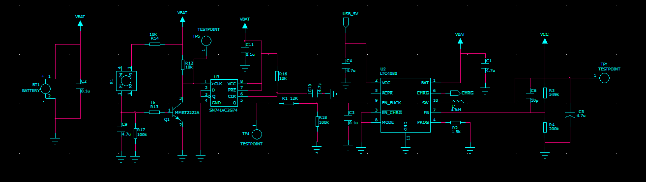

在使用SN74LVC2G74过程中,按键开关能开启电路,即第一次按下去时候Q引脚输出高电平,“Q非”低电平,这是正常的;但是,第二次按按键开关时候,始终无法改变Q引脚的电平(Q引脚一直为高);自己在调试时候发现: 当在“Q非”引脚外接一个负载到地,却又能实现Q引脚电平的正常转换。  查看SN74LVC2G74数据手册,发现我的设计电路与文档中示例并无差异,请问我这问题出在哪里?

    The indicated part of your circuit should be replaced with a Schmitt-trigger buffer for proper operation.
    The output of the debounce circuit currently has two problems:
    1. Output is a falling edge - clock requires a rising edge. If you prefer to trigger on button release, a Schmitt-trigger inverter should be used.  If you prefer to trigger on button press, a Schmitt-trigger buffer should be used.
    2. Output is too slow for CMOS input. The RC circuit formed with R14 and C9 will produce a slow rising edge into the base of Q1, which will produce a similar curve to the input of CLK.  This slow edge can cause oscillation, excessive current, malfunctions, and damage to the SN74LVC2G74.
    Additionally, it is a good idea to add a Schmitt-trigger to the CLR input for the same reason (R16 and C10 produce a slow edge into a CMOS input).  Our application section does show an RC input there, but this is a mistake and will be remedied in the next datasheet revision. This is not as severe of an issue since it only occurs once when power is applied to the system whereas the button triggers the CLK input multiple times.
    For details on how slow inputs can cause problems, please read: Implications of Slow or Floating CMOS Inputs

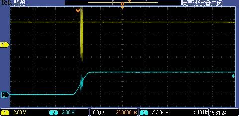

    但是我现在仍然要尝试着调试这块板子,结合您给的启发,首先,我试着将C9和C10这两个电容去掉了,然后用示波器同时检测CLK和Q脚的信号,当按开关时候,发现如图所示波形(上面是CLK信号,下面是Q信号): 从这上面来看,当一个上升沿来到时候,Q脚电平的转变是随机的(有时候能够转变,有时候又不能),这是为何呢?
    第二:如果我CLK引脚不连接示波器,仅仅将示波器连在Q引脚上面,我又发现一个很奇怪的现象:无论怎么按开关,Q脚电平始终为高电平。这让我很难理解?难道连接示波器对我的电路造成了什么影响?
    I have translated your post to English using a translate tool to:
    Hello!
    Thank you very much for your reply. Your suggestion I will apply in the next version of the program.
    But I still want to try to debug this board, combined with your inspiration, first of all, I tried to C9 and C10 these two capacitors removed, and then use the oscilloscope to detect the CLK and Q feet of the signal, when the switch , Found as shown in the waveform (above the CLK signal, the following is the Q signal): From this point of view, when a rising edge came, the Q pin level change is random (sometimes can change, sometimes And can not), why is this?
    Second: If I CLK pin is not connected to the oscilloscope, just connect the oscilloscope connected to the Q pin above, I found a very strange phenomenon: no matter how the switch, Q pin level is always high. It makes me hard to understand? What is the effect of connecting the oscilloscope to my circuit?
    The problem with removing C9 altogether, is that the switch will not be debounced, and therefore could trigger multiple times very rapidly. You may still need to use the capacitor to debounce the switch, but unfortunately that means you would need to use the schmitt trigger buffer or inverter to overcome this issue as Emrys mentioned in the previous post.
    The effect of connecting the oscilloscope to the circuit is that the cabling and the oscilloscope itself provide capacitance. This capacitance may be enough to have the circuit work under some conditions as you have shown previously, but may not be enough to work always.
    It would be recommended to redesign the circuit, as I am not sure you will be able to have the circuit work using the current setup.

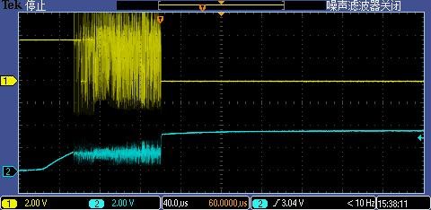

    今天我又进行了大量的实验,发现了与你说的一样的问题:我的三极管输出的上升沿比较缓慢,在Q脚和CLK引脚用示波器检测到剧烈的振荡。我一直尝试着用电容去抵消这些振荡,但是我发现根本就没办法解决;下面我展示几张示波器截图:(黄色代表Q引脚输出,蓝色代表CLK输入)
    第一张图条件是:C9去掉的时候,CLK上升沿触发时候引脚输出信号的变化;
    第二张图条件是:C9为0.01UF的时候,CLK上升沿触发时候引脚输出信号的变化;
    我始终发现了剧烈的振荡,我原本一直以为这些主要原因是我按开关时候抖动造成的振荡,所以一直尝试着消抖处理,然后到现在还是没有能够成功;
    难道我这一部分电路就没有拯救的余地吗?我感到有点苦恼,虽然我可以重新开始一个新的PCB,但是我仍感到遗憾。
    难道上升沿缓慢造成的振荡的问题必须需要一个触发器来解决吗?有其他解决办法吗?

    Yes, any capacitance on the lines connected to the input of the logic device will cause a slow rising edge on the input, and this will cause the oscillation that you are seeing. I don't see any way to salvage the current design without a board change.
    Yes, this slow rising edge is causing these oscillations, and it would be best to fix this with a schmitt trigger input device such as the SN74LVC1G17 : www.ti.com/.../sn74lvc1g17.pdf
    Very happy to help.
    Please let me know if you have additional questions and best of luck with your project.
