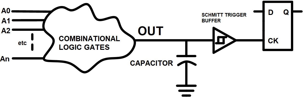

In almost any digital design, clocking or resetting a FF (Flip Flop) is almost ALWAYS decided by some logic conditions. For example: a counter must be reset when, say, A=47, and B is true and C is false, OR D is less than 100 and .... etc. In any application, the moment to reset a FF is always determined by some combinational conditions decoded by gates.
BUT: the output of any set of gates decoding some conditions (like the ones above) may be glitched, may have spurious undesired responses, due to gate delays.

  • Hello Serge,
    It is possible that the data path can be longer than the clock period, there will just be additional delay in propagation of the signal to wait for the additional period.
    If there is a glitch being generated from the output of a preceding logic device that cannot be removed and may clock the input of a D flip flop, a capacitor could be added at the output of the device to suppress this glitch. Since there will be additional capacitance on the line to suppress such a glitch, it would be recommended to use a schmitt trigger input device to be able to tolerate any slow edges.
    In this way, the glitch is removed into the schmitt trigger buffer, and it generates a clean fast rising edge input into the CLK of the flip flop which should only clock a single time because of this clean edge. A device such as the SN74LVC1G14 or SN74LVC1G17 would work.
    This should help to avoid any issues due to the glitch.
    Hope this helps!
    Michael
  • Hi Michael,
    Thanks for replying.
    1- Let us postpone the path delay vs clock period for the moment.
    2- I would like to make sure that we have both the same understanding of the solution proposed by TI.
    Let us sum-up. In most applications of the real world, it is often required to clock a Flip Flop (FF) or a set of FFs only if some conditions have been detected by a combinational circuit made of logic gates. Such combinatioal gates are prone to spurious response, glitches, spikes, etc. at their output, due to various gate delays within the circuit. Spikes, glitches, spurious response are absolutely normal in combinational circuits.
    Consequently, the output of these combinational circuits may not be used directly to clock a FF, nor to reset it, since transitory responses (glitches, spikes, etc) would falsely clock or reset it.
    The solution proposed by TI would be to add a capacitor to the output of the combinational logic, in order to filter-out its transitory false outputs, and adding a Schmitt trigger buffer to get a nice clock (or reset) signal.See the attached image.
    Have I understood correctly the solution proposed?
    Thanks for your help.
  • Hello Serge,
    Yes, depending on the severity of the glitches/output levels, the capacitor on the output, and maybe a series resistor, could be added to clean up some of these glitches and then when there is a true rising edge, the schmitt trigger will be able to clean up the slow edge to provide a single fast rising edge input to the clock of the flip flop.
    Obviously this solution could limit the maximum operating frequency of the system depending on how fast the desired operation is and what the expected spikes are.
    Do you have a scope shot of your setup that you are concerned with?
    Michael
