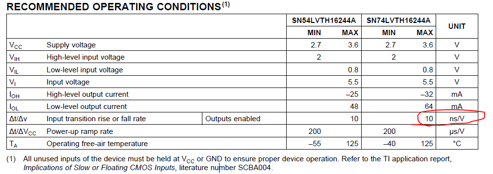

I have one question about SN74LVTH16244A Input transition rise or fall rate.

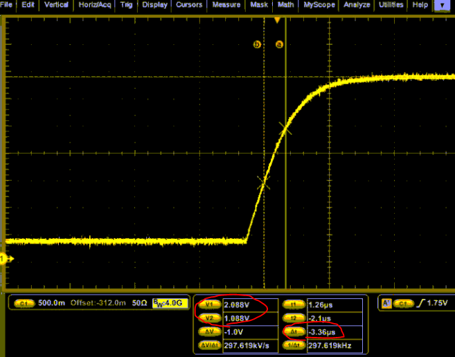

In datasheet, the input transition rise or fall rate is 10ns/V maximum as shown below. But in customer's test, the result is 3.36us/V shown in below waveform.
My questions:
1. What is the minimum value of input transition rise or fall rate?
2. How is the risk for customer's test rate?
Thanks.

  • Hi Johnny ,
    It could be a potential problem for the customer with such slow rising inputs.
    www.ti.com.cn/.../slla364a.pdf
    Please refer to this white paper which talks about implications of having slow rising edge inputs in general.
    However, in case of bus hold inputs it may be different if the feedback circuit internally holds a value until switched. In any case , i would suggest using a schmitt trigger device ahead to square up the signal.
  • Hi, Shreyas,
    In customer's application, this slow rising edge only occurs once or twice when the system first starts up. After startup, the input of SN74LVTH16244A will be a constant high or low voltage, no pulse signal any more.
    So how about the risk of this?
    Thanks.
    Johnny
  • Hi Johnny ,
    The risk is not with the device but for the system performance. The slow rising edge can cause some oscillations or signal integrity issues and if the customer is fine to accept it then there is no concerns w.r.t the device.
    also , to note that if the Vcc is also ramping along with input signal at startup(slow or fast) , it wont cause issues.
  • Shreyas,
    Thanks for your reply.
    I have another question, for SN74LVTH16244A, is there any requirement of Bushold Input Over-Drive Current to Change State?
    Thanks.
    Johnny
  • johnny ,
    The bus hold current is defined in the electrical spec as Ii(hold) which is the over drive current required to change state of the inputs.
