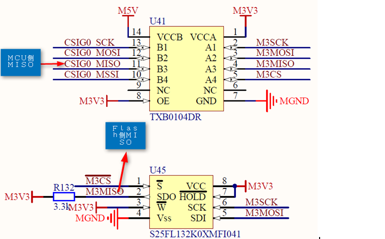

We are using TXB0104 level translator in one of our custom board to shift SPI 3.3<-->5V
As below picture, you can the Green is MISO wave that is not normal wave, can you explain what cause the wrong wave? Thanks~.
