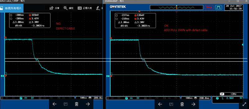

  • Hi Emrys.

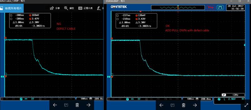

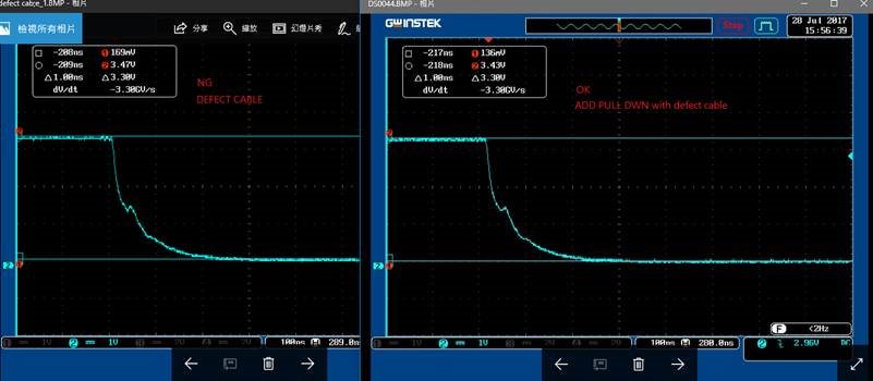

    Customer try to place the 10kohm to GND at the input of SN74LVC1G3157 and it works.  SOme questions from customer as below,
    1. How can we judge if 10kohm is the best value for it?
    2. Customer didn't finsd waveform difference before/after adding 10kohm at the input of SN74LVC1G3157 (as shown below.)  Do you have any comments?
    Antony
  • It looks like there is a reflection in the line causing a slight spike at about Vcc/2 - which can be problematic since that is the threshold voltage for most CMOS inputs. I would say that the best fix would be to add a Schmitt-trigger buffer at the distant end of the cable (prior to the SN74LVC1G3157).  This will eliminate any chance of the reflection causing a double trigger.
    As for why they see an improvement - note that the 10k resistor reduces the reflection slightly, as shown here:
    That reduction is likely just enough to avoid a double trigger in their current setup - I would not trust it to _always_ be fixed, however, due to variations from device to device.
    If the only option is to add a terminating resistor, lower values will be better to reduce the reflection. The closer you get to the cable's characteristic impedance, the better - however, you cannot exceed the current driving capabilities of the driver device and if you have a perfect match, the signal's value will be cut in half and it won't be recognized at the distant end.
    A better solution is to add a series resistor at the output (prior to the cable), which will dampen oscillations.
    Yet another option would be to increase the cable length slightly (perhaps 1/8 to 1/4 wavelength) - by changing the length of the cable, you can change when the reflection hits the edge, and move it outside of the switching threshold range of the device you are communicating to.
