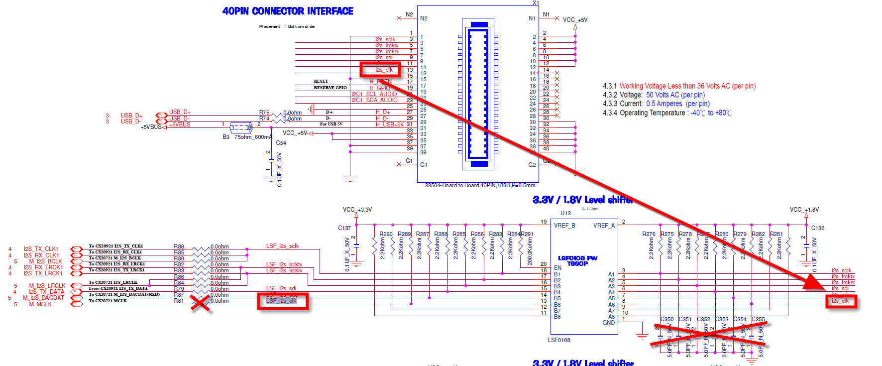

Hi Sirs,
Sorry to bother you.
Our schematic
We have tried to change the pull up resistor.

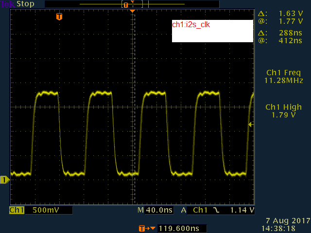

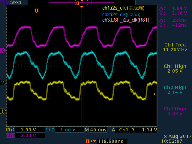

We use LSF0108, We found our waveform distortion
No passing level shift
Passing level shift
We would like to know how to fix it.
Could you share your experience for us?
Thanks!!

  • Hi Shu -Cheng ,
    I notice that the LSF biasing is not right for a start. The 200Kohm needs to be connected to Vrefb and EN. Currently , it is connected to only EN pin which will not set the correct biasing.
    The I2S as i know is push pull interface and you dont need the pullup resistor at the input. However , 1.8V to 3.3V up translation needs pullup resistor.
    what is the output cap including the load & trace capacitance ?
