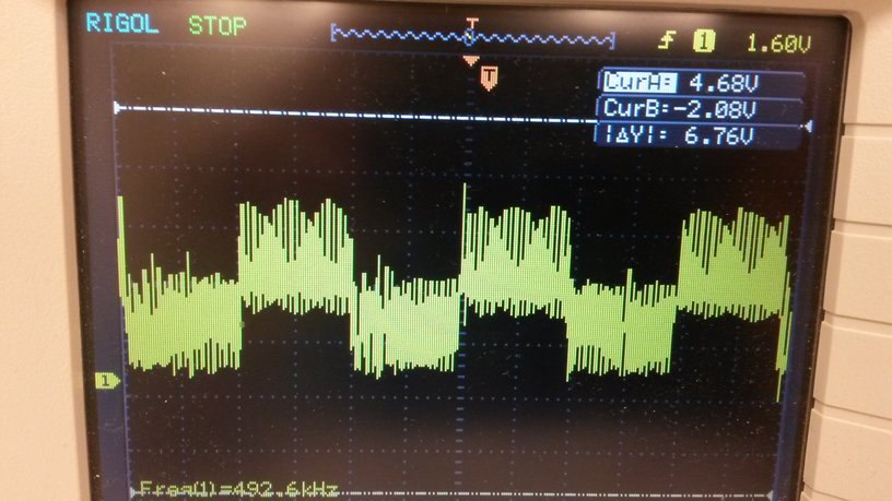

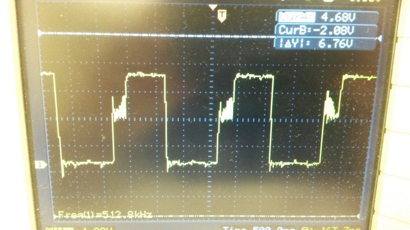

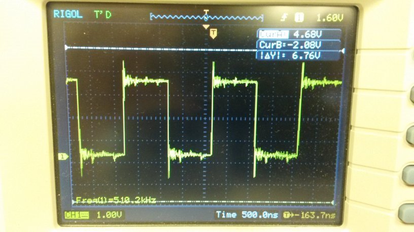

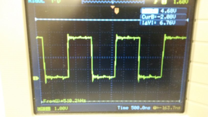

    In any case; here are some screen capures of SCK (the other signal show the same behaviour):
    Generator SCK connected to Port A. Power on port A, No power on port B.
    Generator SCK, and anayzer SCK, connected to Port A. Power on port A, No power on port B -> More capacitance seems to reduce ringing.
    Generator SCK, and anayzer SCK, connected to Port A. Power on port A, Power on port B.-> Audio starts to sound like ***.
    Generator SCK connected to Port A.. Anayzer SCK connected to PortB.  Power on port A, No power on port B. -> Audio (obviously)l sound like ***.
    To me it seems as if the chip is confused about port directions ...
    \Eric
  • The UPV-B41 has a specified output impedance of 50 Ω; this should not be a problem.
    The TXB0104's outputs are extremly weak (to allow auto-sensing of the direction). They are designed to drive capacitive loads of up to 70 pF; larger loads prevent fast switching.
    This is possibly what is shown in the third waveform. Apparently, all your adapters and cables exceed that 70 pF limit.
    You do not need an auto-sensing bidirectional translator for I²S. Try a unidirectional or direction-controlled translator, such as the SN74AVC4T245.
