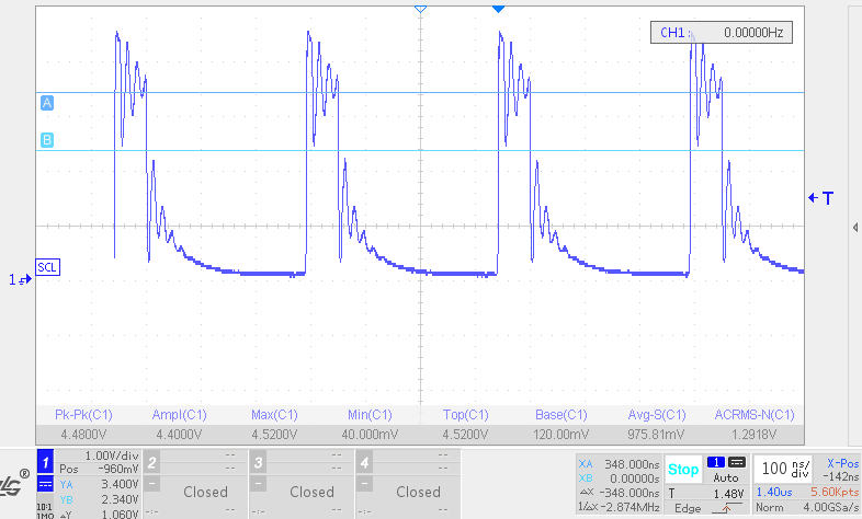

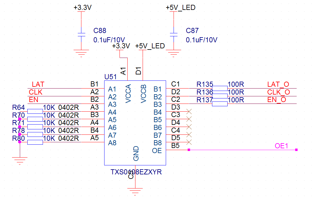

My customer is using the TXS0108E now. The MCU GPIO control the LED array with TXS0108S to change 3.3v to 5v. There are some high frequency oscillation happen. The frequency is about 40Mhz. I have let the customer remove the TXS0108S, the oscillation disappear. Could you please help check why? Thanks.
We do the test below.
The schematic
The ouput connect the line like above and float.
the line output is above
MCU output is above

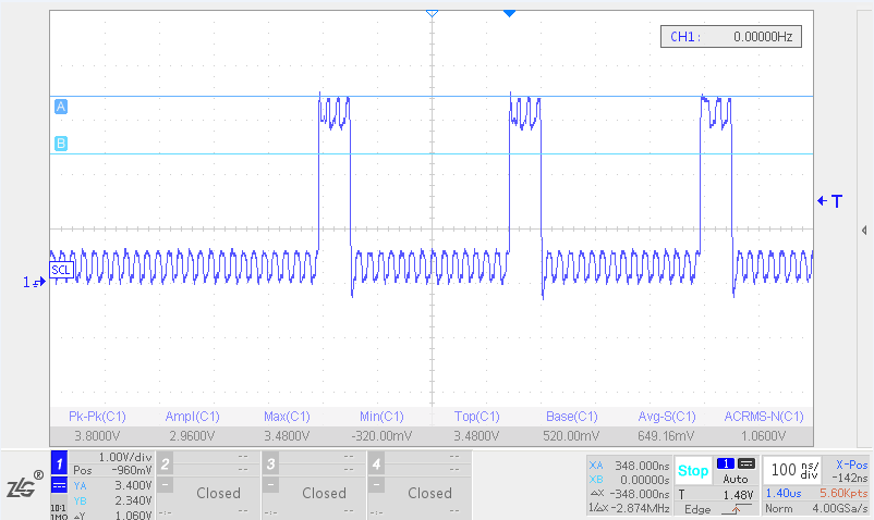

TXS0108S input A2 is above, the resistor between the MCU and the 0108s is 100ohm.
So we remove the C1 D2 C2 outout line, the TXS0108 output become much better.below.
i have let the customer keep the line and remove the 0108s with three 0ohm resistor.
The waveform high frequency oscillation disapper too.
