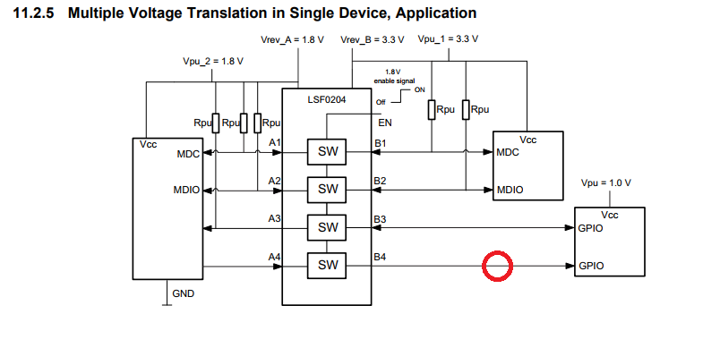

Where customer and I both cannot understand is why the red mark below don't need a pull up resistor?
Because the Vcc 1V is much small than Vref_B voltage. I cannot understand how this would work (I mean what voltage will appear at B4 pin?), please kindly teach me, thanks.
Andrew
  • Hi Andrew,
    Good catch. The way the circuit is drawn currently the signal on A4 would be directly transferred to B4, resulting in a 1.8V signal at the red circle. This was likely not the intent of whoever drew this circuit.
    There is an error in the datasheet. In order for this to work, the voltage at Vref_A would need to be 1.0V, and the wire connecting Vpu_2 to Vref_A would need to be removed (also, Vrev_A should be Vref_A...)
  • Thanks for the feedback!
    Can we just add an extra pull-up 1V at where red mark without changing Vref_A voltage?
    Will that work?
    Thanks.
    Andrew
  • Unfortunately, the LSF0204 will never be triggered with the thresholds set as they are (1.8V). If you have to come up with a work-around, one option would be to add a clamp diode to limit the 1.8V signal to 1V, but there would have to be a series resistor as well to limit current through the diode, and it kind of defeats the purpose of having a translator.
    The best solution is to set the reference voltage to 1V. All other channels will still work fine with the lower threshold.

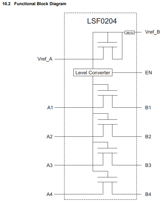

  • This is exactly the thing I don't understand. Please allow me to ask more. How Vrev_A & Vrev_B works inside the device? If it acts as a pull up, then why needs additional pull up resistor? Thanks for teaching.
  • The datasheet has a very good block diagram in section 10.2
    The FET threshold voltage is set by Vref_A. Essentially, when any input is near the threshold (or above it), that FET will go into a high-impedance mode. When the input is below the threshold, the FET is turned on.

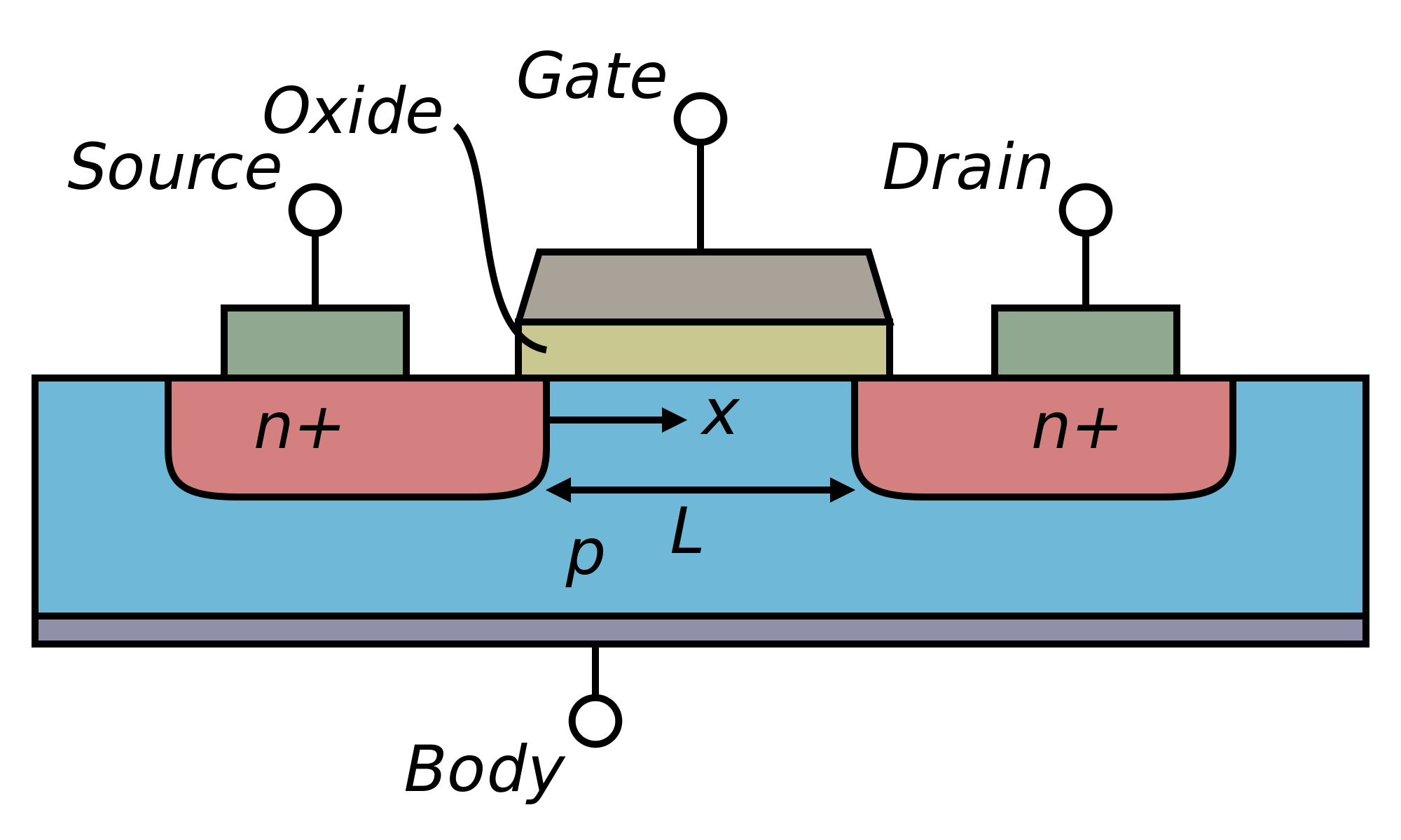

  • The A and B sides are labelled correctly -- I swapped the sides for convenience in my drawing.
    Current can pass both ways through the LSF device.  The device is voltage controlled -- if (VG - VS) > Vtn, current will pass.  Since VG is a set bias value, VS is the only value that can affect the FETs state.
    The most confusing part of the device is that there isn't a set 'source' and 'drain' -- the 'source' is typically identified as the side of the FET that is shorted to the Body, but in this case, the Body is connected to ground, and the Drain/Source are symmetric.
    (borrowed image from https://electronics.stackexchange.com/questions/212768/p-chanel-mosfet-series-configuration)
