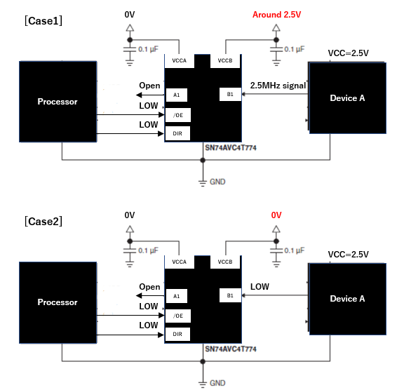

We are evaluating SN74AVC4T774RSVR at the following conditions.
Case1: VCCB pin is 0V but if we input the 25MHz signal to B1 pin, VCCB becomes 2.5V.
Case2: VCCB pin is 0V if we input the low signal to B1 pin.
So, we guess that the voltage of B1 pin appears to VCCB pin.
Is this behavior right?

    I believe this kind of behavior is unexpected with the SN74AVC4T774.
    The device has Ioff partial power down feature which will enable the I/Os to stay active while either of the Vcc is held at gnd. It prevents leakage from I/O ports to accidentally turn on the device through the clamp diodes.
    can you try to disable the OE pin and try to see if the issue persists ? can you try other devices , preferably from another lot in case you have the access?

    When you mention that the Vcca / Vccb is at 0V , is the supply turned off(floating) or is it forced to 0V ?
    -> (My answer) the supply is turned off(floating). If it is floating, may a phenomenon of “case1” occur?
    Kanemaru
  • Kanemaru ,
    The Ioff feature requires the supplies to be held at or near 0V. floating node doesn't guarantee 0V. Case 1 is definitely a possibility.
