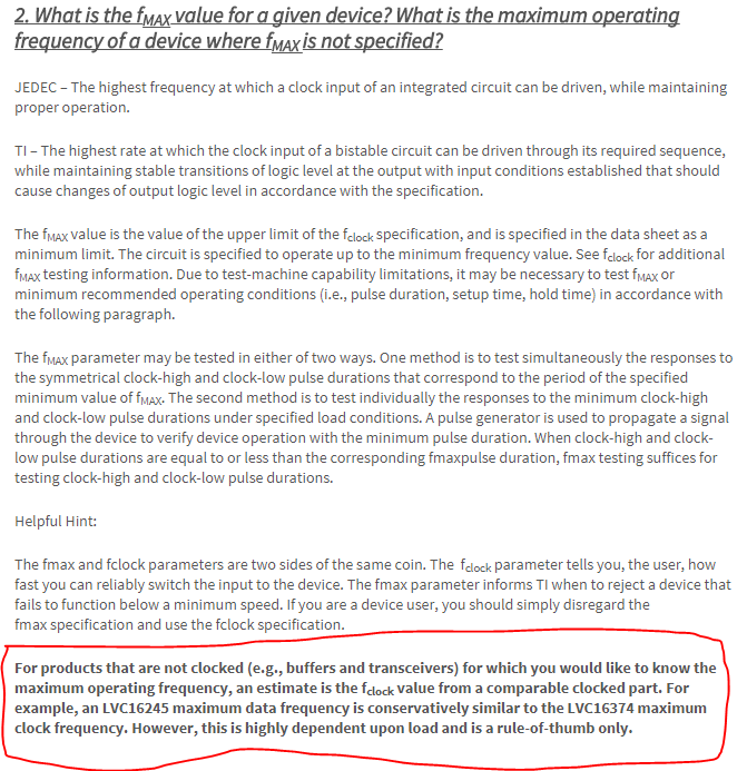

    And since this part is not a clocked device, the answer is at the end of that section:
    It's easy to find a comparable clocked part - on http://www.ti.com/ just search for "alvc" and look for the first Flip-Flop -- I selected SN74ALVCH32374.
    This device has a rated frequency of 150 MHz from 2.5V to 3.3V operation. Since the SN74ALVCH32374 is built on the same technology as SN74ALVC164245 but is significantly more complex, it is safe to say that the SN74ALVC164245 will also operate well at 150 MHz.

    The maximum operating frequency of 150 MHz indicates that the device can transfer up to 75 Mbps max at both 3.3V and 5V.
    I'm afraid that we do not have characterization data for data rates on this device, so it is not specified in the datasheet. That is why we have to look at a similar device with a clock input for the maximum operating frequency. It is likely that this device will work at much higher frequencies, but I cannot guarantee it without proper characterization.
