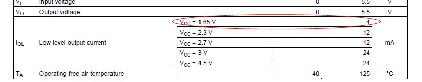

    If Vcc=1.8V,  the max low level output current is 4mA. Then using a 330 ohm pull-up resistor, the low level output current is about 15.2mA. Is it ok?

  • Hi Kevin,
    Short answer: it's best to stick with the recommended maximum in the datasheet.
    This device can sink up to 50 mA of continuous current (see the absolute maximum ratings table).
    The value you have highlighted is the recommended IOL maximum. If you look in the Electrical Characteristics table, you can find that the VOL at 4mA and 1.65V supply is 0.45V, which means the output has an impedance of 0.45V/0.004A ~= 112.5ohms at this low operating voltage.
    As long as the supply is constant, the output impedance will remain relatively constant as well, so we can calculate the VOL at 15.2mA of current to be: 0.0152*112.5 = 1.71 V. Note that the large change in VOL will probably cause issues with whatever this is driving. To remain below 0.45V, keep the current below 4mA.
