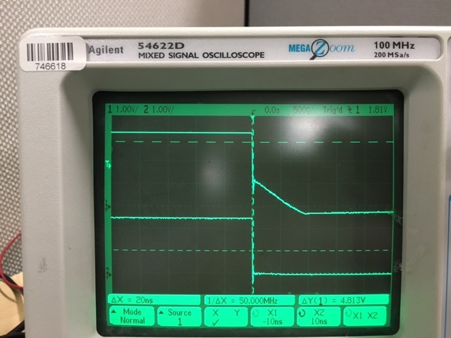

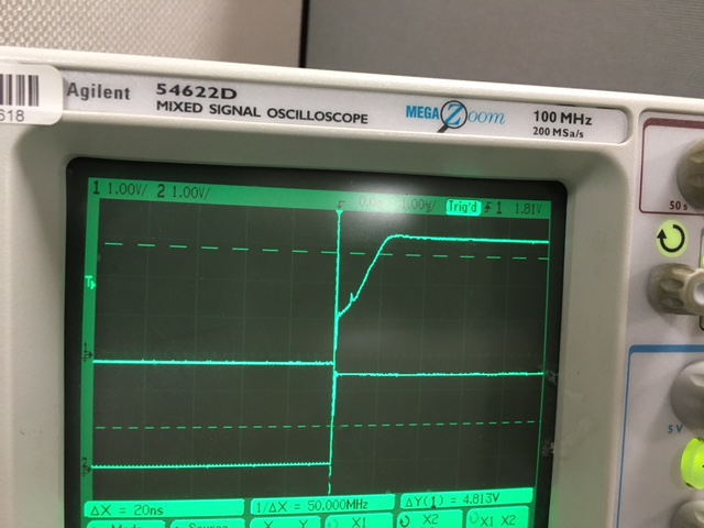

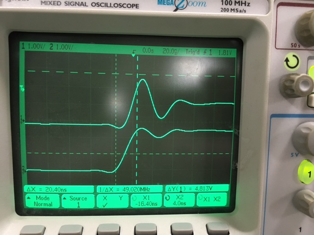

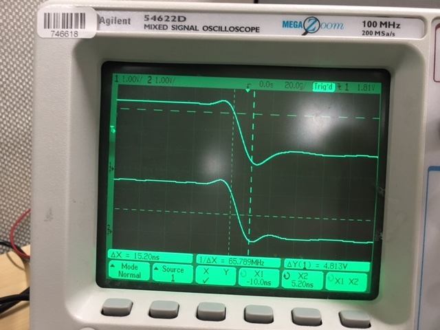

I am using the TXS010x devices to level shift between 2.5V and 3.3V and I am seeing some signal distortion.
Below is the level shifter schematic.
In the below waveform the bottom trace is the L side, which is being driven push-pull to 2.5V, the top trace is the H side and is floating. H is being used to monitor the L side but at 3.3V.
The H side does also go to the input of an op-amp but should be loading minimally.
We need this to be bi-directional since these signals are GPIO signals.
Is this expected?
