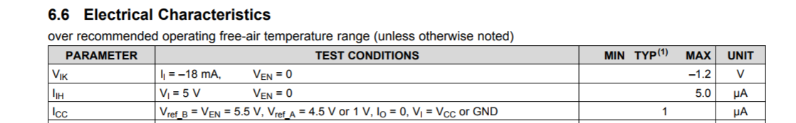

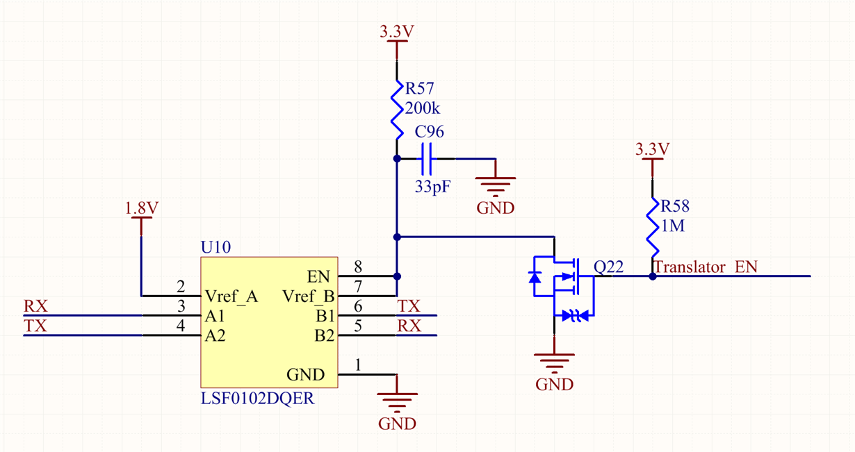

I'm trying to figure out the power consumption of the LSF0102DQER level translator. The picture below states ICC is 1uA, is this for both power supplies? Does this number increase with the number of data channels being used?i'm using 2( RX and TX). Does this change if VCCA or VCCB change? im using 1.8v to 3.3. what is the quiescent current?
Thank you!
