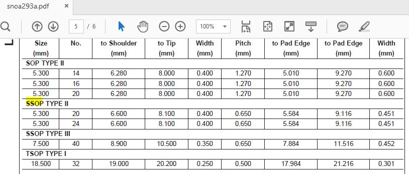

Would you pls advise that if we can design the TXS0104EPWR (TSSOP-14)'s land pad following SNOA293A's recommendation, while it defines 20 and 24 pins TSSOP?

Hello Wayne,
That app note does not cover the TSSOP package that you are referring to.
I would recommend you look at the landing pattern for the PW package for another device that is 14 pins that is correct.
Please refer to the PW landing pattern that is provided in this datasheet:
http://www.ti.com/lit/ds/symlink/sn74lvc07a.pdf
Page 30 has a good example, which is what I believe you are looking for.
