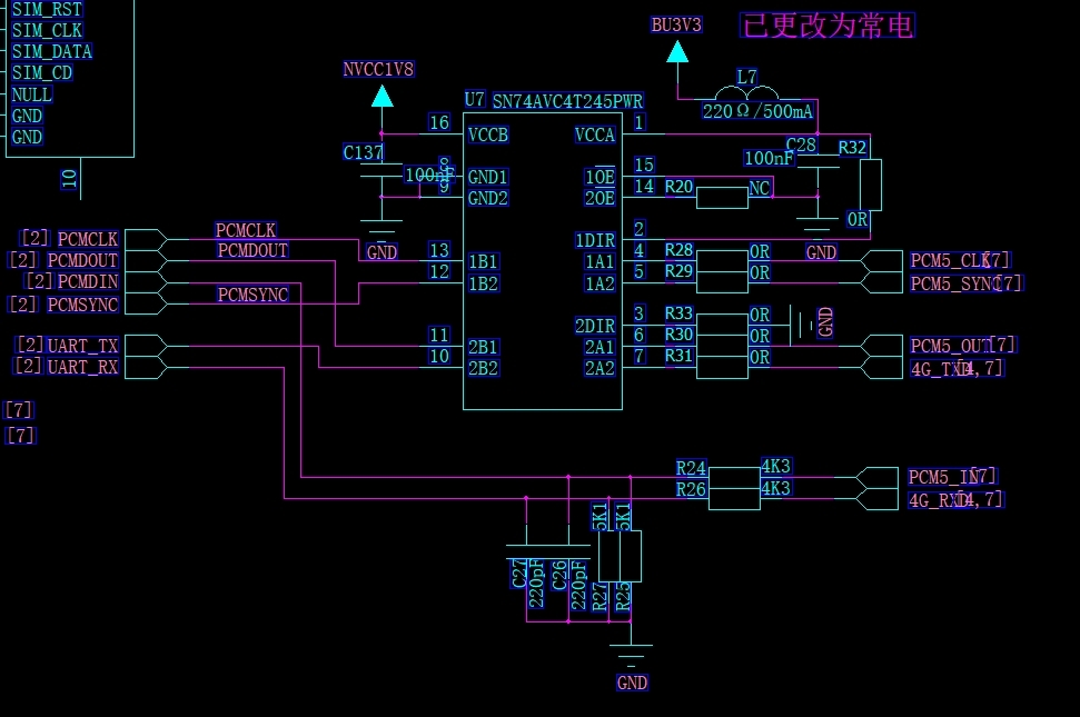

Could you help review below application circuit from my customer? The customer only uses port 1 for data communication, and port 2 is reserved.
- If the customer doesn't use port 2, 2OE must be connected to VCCA through a 10kohm resistor, is that correct?
- If port 2 is reserved, are there any requirements for the input/output signal of port 2?
- In customer's mass production products, they found 2 pcs device will have excess Icca current (about 4mA), do you think there is something to do with their design, or we need to do some IC level analysis? https://e2e.ti.com/support/logic/w/logicfaq/3539.04-power-thermals#Question02 According to this link, the increase of Icca is uA, not mA.
