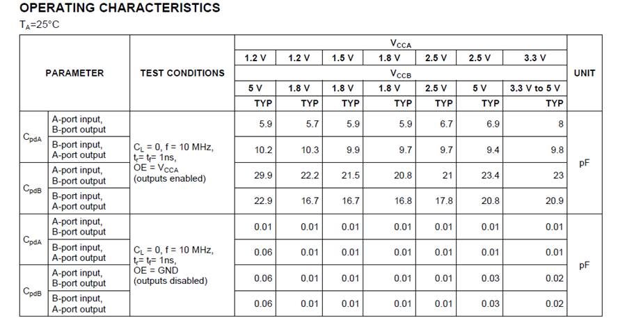

We would like to know how to Measure CPDA or CPDB?
Because we use TXS0108E on SMBUS DATA/SMUBS CLK, the level is +1.8V transfer to +3.3V M.2 wifi
For now we saw the SMBUS DATA couldn't low when we connect some module M.2 wifi.
The phenomenon will effect the system couldn't turn on system.
So, we think because some M.2 wifi CPDA or CPDB are over spec
Could you share experience for us?
