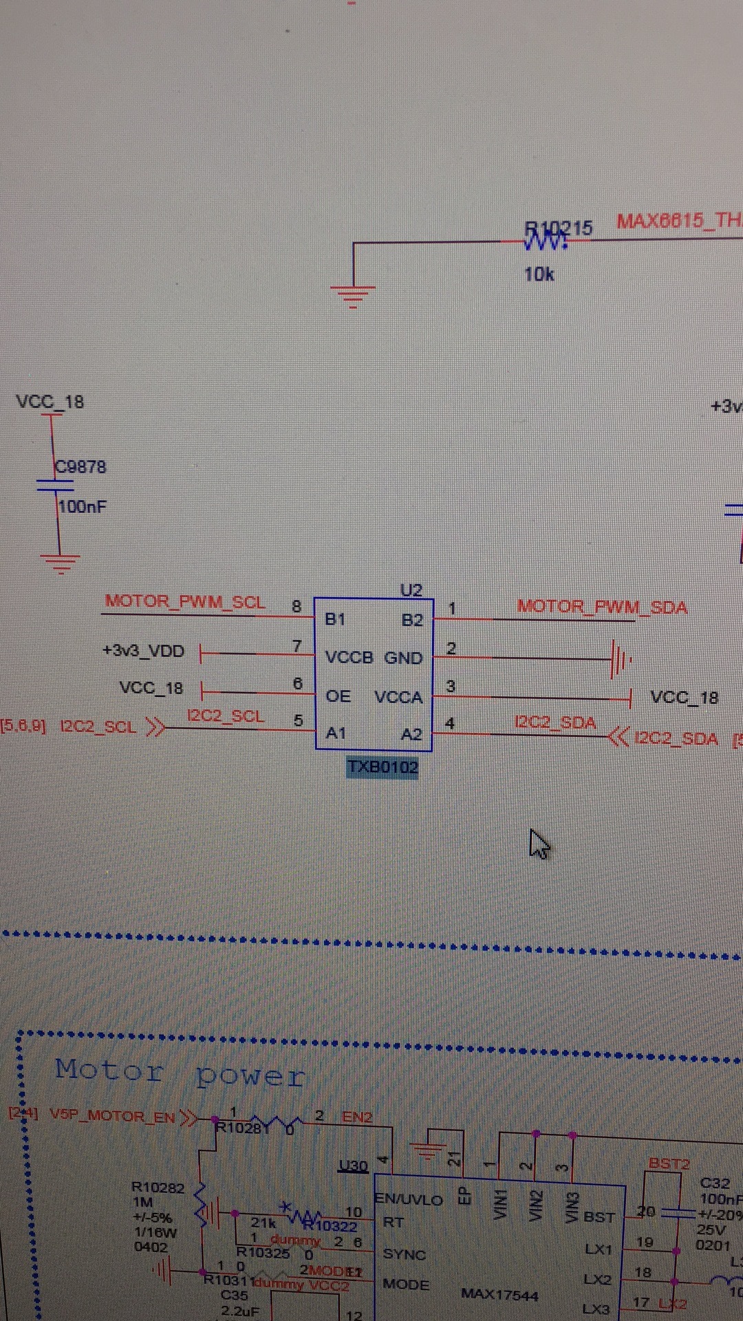

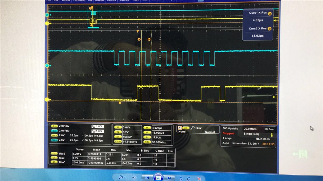

we translate the I2C from 1.8V to 3.3V, but however the part couldn't work.
change NXP NTS0104 the schematic can work.
TXB0102 couldn't work also.
attach the schematic and TXB0102 is mistake, we'll change schematic to TXS0102
signal line has pull up.
