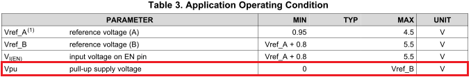

        In the data sheet the following is stated.
      The video "1.7 Multi-voltage Translation with the LSF Family" is as follows.
      Is there no problem if Vpu becomes larger than Vref_B ?

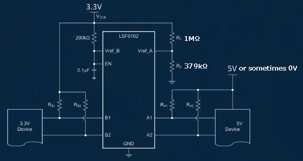

    2) I know to connect to Vref_B via 200kΩ. I want to know are the following.
           Is there any problem when Vref_B is 0V from time to time? Is there damage to the device?
      If it is NG that Vref_B becomes 0V, is it better to configure a single supply as follows?

  • Hi Kato-san,
    I believe that whoever wrote the application section was making a recommendation of VrefB as the maximum voltage for their application, but it is not a requirement for the LSF series of devices. The absolute maximum ratings table shows that each I/O can be between -0.5 to 7V regardless of the supply values, and the recommended operating conditions table shows 0 to 5V on all I/O pins to be safe.
    Vpu can definitely be larger than both supplies.
    Forcing the VrefB pin to 0V will not cause any damage to the device, and is actually how we recommend disabling the device (see the video on the Enable pin for details).

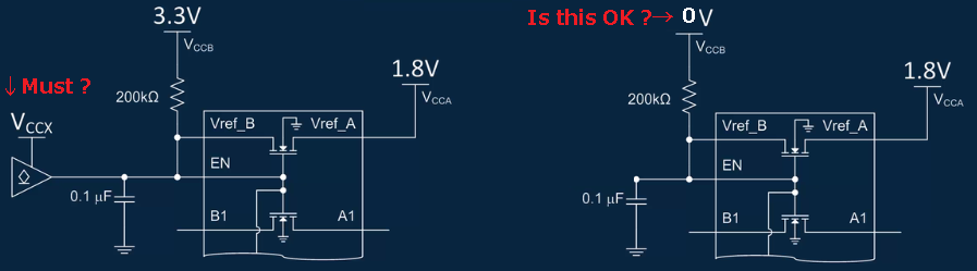

  • Hello Emrys-san,
    Please tell me how to disable it.
    Is it required to 0V with an open drain device to disable it?
    Is there no problem by setting Vccb to 0V?
    Kato
  • Hi Kato-san,
    The left hand approach is the typical method for disabling the device because usually the power rails remain on.
    The device can also be disabled as you ahve described. Applying 0V to Vccb will very quickly result in a negative VGS across the bias FET, turning it off. The gate voltage for all channels will then be 0V.
