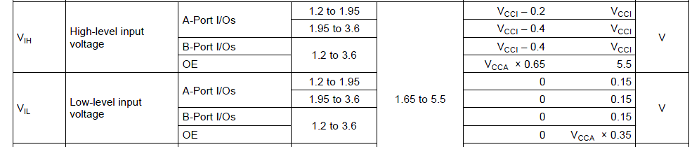

In TXS0108E datasheet, when setting A-port power voltage to 1.8V, VIH range is 1.6~1.8V, VIL range is 0~0.15V.

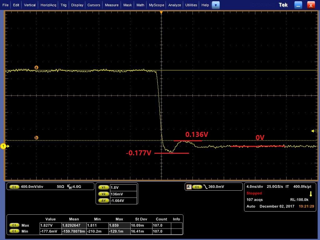

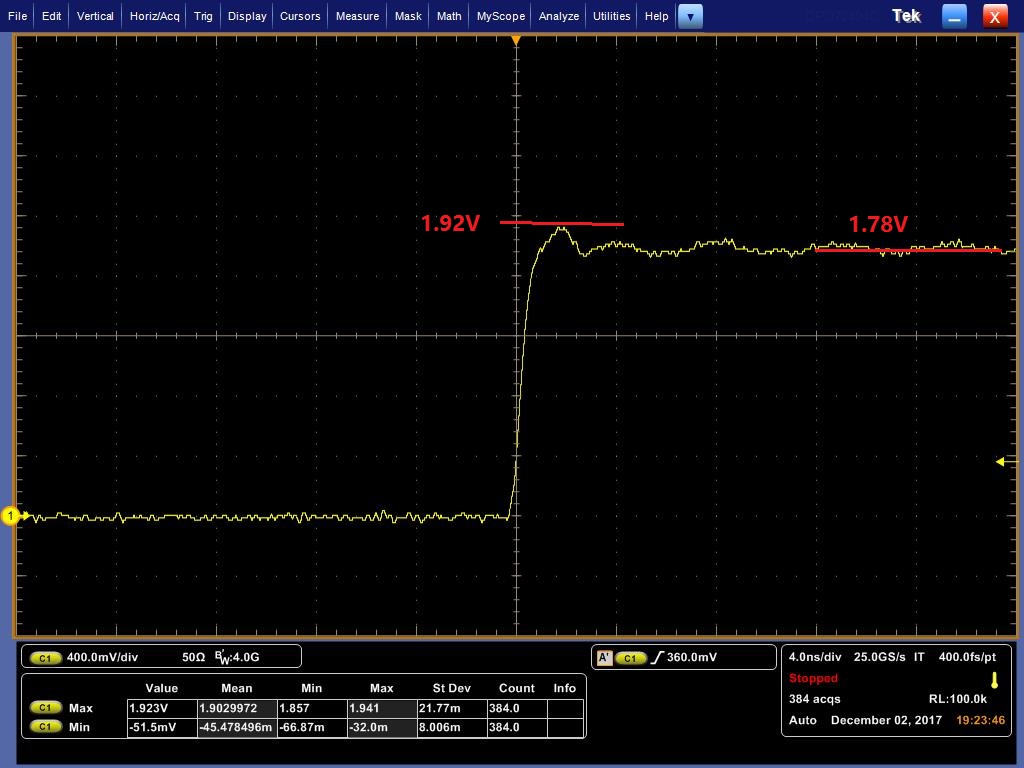

In customer's test, the A-port signal voltage is as below.
For LOW-HIGH, the overshoot is 1.92V, the static is 1.78V.
For HIGH-LOW, the negative undershoot is -0.177V, and the first ringing peak is 0.136V.

  • 1. Those over/undershoots are harmless. As shown in the absolute maximum ratings, they must not exceed 0.5 V (if the current is larger than 50 mA).

  • Hi Johnny,
    The TXS0108E does need the input voltage to be at least 1.6V to reliably detect a 'HIGH' input.
    I'm certainly no expert on NXP's parts, but the LS1043A datasheet lists VOH as 1.35V minimum with IOH as 0.5mA (about a 900 Ω driver).
    When the LS1043A is attempting to drive the line HIGH, is there anything else on the line holding it low? Ie, is there a current draw of 0.5mA on the driver?
    If not, then this should work fine. The only thing (typically) pulling the line low when the driver is switched would be the leakage current, which is on the order of 1uA. Even a weak driver should have no problem pulling the line up very close to 1.8V.

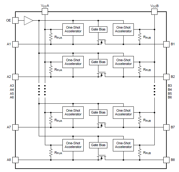

    What I would be more concerned about on that device is the output LOW voltage. Since the TXS0108E has 10kΩ reistors on each input, the driver will have to sink approximately (assuming 1.8V to 3.3V operation):
    (1.8V - 0.4V)/10kΩ + (3.3V - 0.4V)/10kΩ = 0.43mA. (getting close to their listed 0.5mA spec)
    As long as those are the only pull-ups on the line, it should work fine - but if anything else is adding current (ie the driver has to sink more than the 0.5mA spec), you might see the VOL drift up to unacceptable levels.

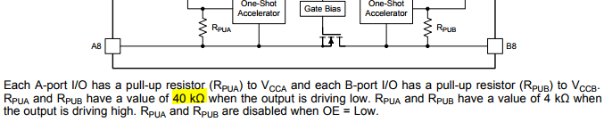

  • Hi Johnny,
    To answer your questions one by one:
    1. So the internal RPUA and RPUB are all 10k pull-up resistor?
    No, I mistakenly used a value from a different TXS device of 10 kΩ. The datasheet lists the correct value (40 kΩ) just below the image you posted:
    So, my calculations are off by a factor of 4 -- the current is one fourth of my original estimation.
    2. If we pull-up A1 or B1 pin through extra pull-up resistor, for example 4.7k, the LOW voltage will be a bit higher than normal. Am I right?
    Yes, the driver will have to sink extra current due to the overall reduction in pull-up resistance, and sinking more current means it will have a higher VOL.

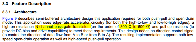

    3. What is the ON resistor of internal Switch?
    This is in the datasheet, also just below the image you posted:

  • The TXS does not have an input impedance because it does not have inputs; each channel is a passive switch.
    When neither side is pulled low, the FET is off. In the worst case. the leakage current is less than 20 µA, so with the output impedance of 0.45 V / 4 mA = 112.5 Ω, the voltage drop is less than 2 mV.
  • Thanks for the clarification. I think I understand now.
    When A1/B1 is high, the internal FET is off and the internal pullups bring up the voltage to its respective VCC level. When A1/B1 is low, the internal one-shot causes the FET to turn on and thus passing through the logic low to the destination chip. As long as the signal traces aren't too long, the TXS should have no trouble driving the required logic levels to communicate properly with the processor and the WiFi module.
