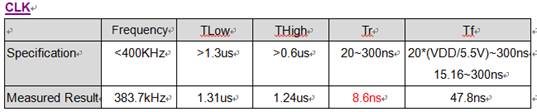

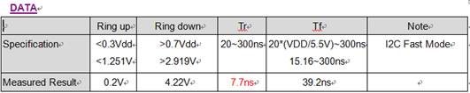

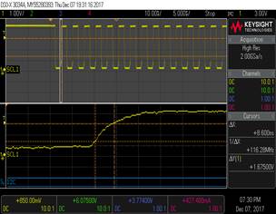

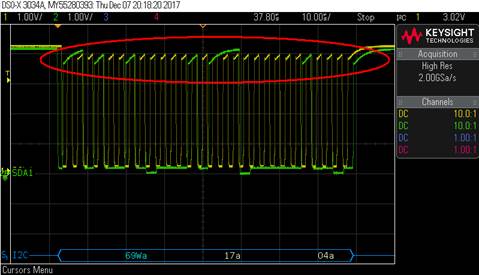

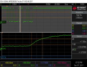

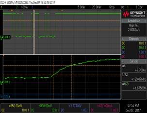

We have a timing issue about the rise time is too fast.(measuring: 8ns, spec: 20ns~300ns)

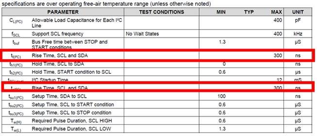

  1. Could you provide the latest spec of TI TLC59116IPWR for I2C timing?
  2. Could the one-short circuits be turn off for the TXS0104?
  3. Is there any side effect when the rise time is too fast to cause over spec?

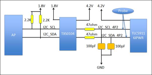

l   The block diagram is shown as below:
Thanks!!
  • The TLC59116's timing requirements are just copied from the I²C specification.
    In practice, faster edges will work fine as long as there is not any ringing that would make the voltage dip below 70% again.
    The TXS's edge accelerators cannot be disabled.
    If you want to slow down the edges, increase the 47 Ω and/or 100 pF values.

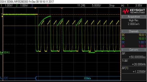

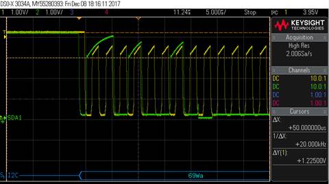

    Actually we have use 47ohm and 100pF RC delay circuit already, because one-short pull-up driving too strongm, there will effect rise time always smaller than 20ns. (Tr: 8ns)
    l If we use Cap 220pF, The wareform will be Charging triangle wave( Tr: ~17ns, still smaller than 20ns)
    l If use too large Cap value, there couldn't to right high level value.
    We saw there have another IC "TAS5760M", the Tr and Tf as long as<300ns is OK.
    We would like to know does TI have definition same I2C spec between TAS5760M and TLC59116IPWR?
    Because if yes, the TLC59116IPWR spec is <300ns, we think this test result is reasonable

  • I'm not really sure what you're trying to do. You shouldn't add capacitors to the TXS -- it works very well with I2C the way it is. TI also offers I2C specific devices (such as PCA9306) if you are wanting to get something specifically made for I2C.

    1, Looks, TI TLC59116IPWR rise time must meet 20ns< Measurement value <300ns. right?
    2. TLC59116IPWR rise time can same as TAS5760M (<300ns)?
    3. Continue Q2, If different rise time between TLC59116IPWR and TAS5760M, why? because I2C IF electric circuit design have different?
