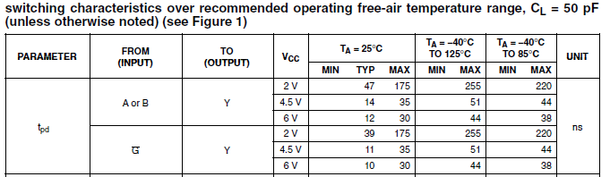

Is there VIH_min and VIL_max value under Vcc=3.3V?
2)
Is there tpd_max (A or B to Y, notG to Y) value under Vcc=3.3V?
Yaita / Japan disty
  • Hello Yaita-san,
    Any interim value can be calculated from the datasheet using linear interpolation from the nearest two points. In this case, 2 V and 4.5 V values would be used to get the 3.3 V value.
    If you would like me to provide the calculation, please let me know.
