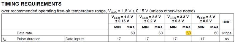

1. If our application data rate is over spec, there will any risk on it?

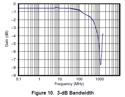

2. Does TXB have similar pic as below?

  • Hi Shu-Cheng LIN,
    If you have the application requirements, please let us know.
    The max data rate for the TXB0104 device is guaranteed to be a minimum of 60Mbps as per page 9 of the datasheet. It can perform better than the rated specs but will depend on the application setup and conditions.
