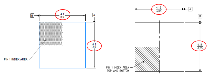

Part Number: TXS02612
Could you tell me the package size of TX02612 ?
There are two types of description in the data sheet.
Which expression is correct?
Customers need that information for CAD design.
Yusuke/Japan Disty
Yusuke/Japan Disty

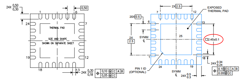

Maier-san,
Let me ask you one more thing.
There is no thermal pad size information on the page where +/- 0.15mm is stated.
However, thermal pad information exists on the page where +/- 0.1 is stated.
Can I believe this(2.45× +/-2.45mm) information?
Could you tell me the thermal pad size.
Yusuke/Japan Disty
