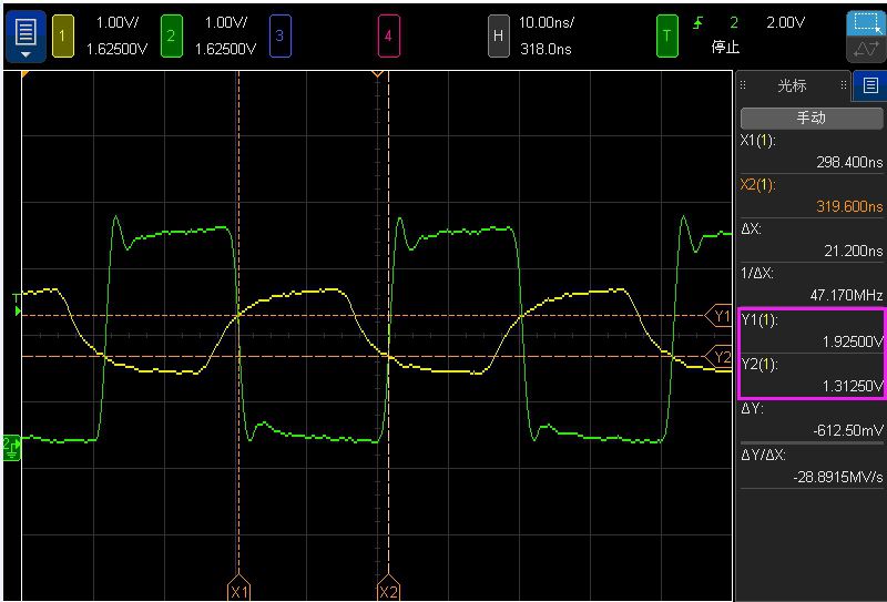

We found SN74LVC1G04DCKT trigger level mismatch with the datasheet
Waveform as below
when we use triangular waves as input,the trigger level is 1.56V,It's not in conformity with the specification.

The SN74LVC1G04 has a standard CMOS input - meaning that it triggers at ~Vcc/2 and _should not_ have slow inputs as shown above. I'm guessing you are confusing VIH (High-Level Input Voltage) with Vt+ (Positive-Going Input Threshold Level). These specifications are not equivalent.
Also, the datasheet specifically lists the maximum input transition rise or fall rate (Δt/Δv) as 10ns/V at 3.3V operation -- the edge rate above appears to be ~50us, approximately 1500x slower than what the datasheet lists. Such slow inputs can cause oscillation and damage as explained in this application report: Implications of Slow or Floating CMOS Inputs.
There is an application report that explains each specification in detail located here: Understanding and Interpreting Standard-Logic Data Sheets
