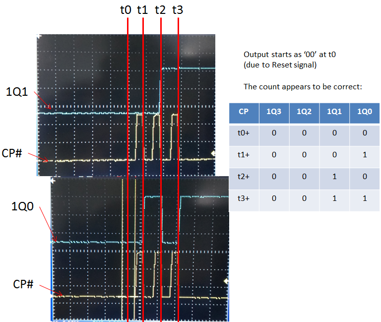

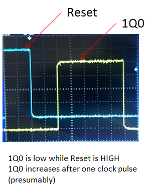

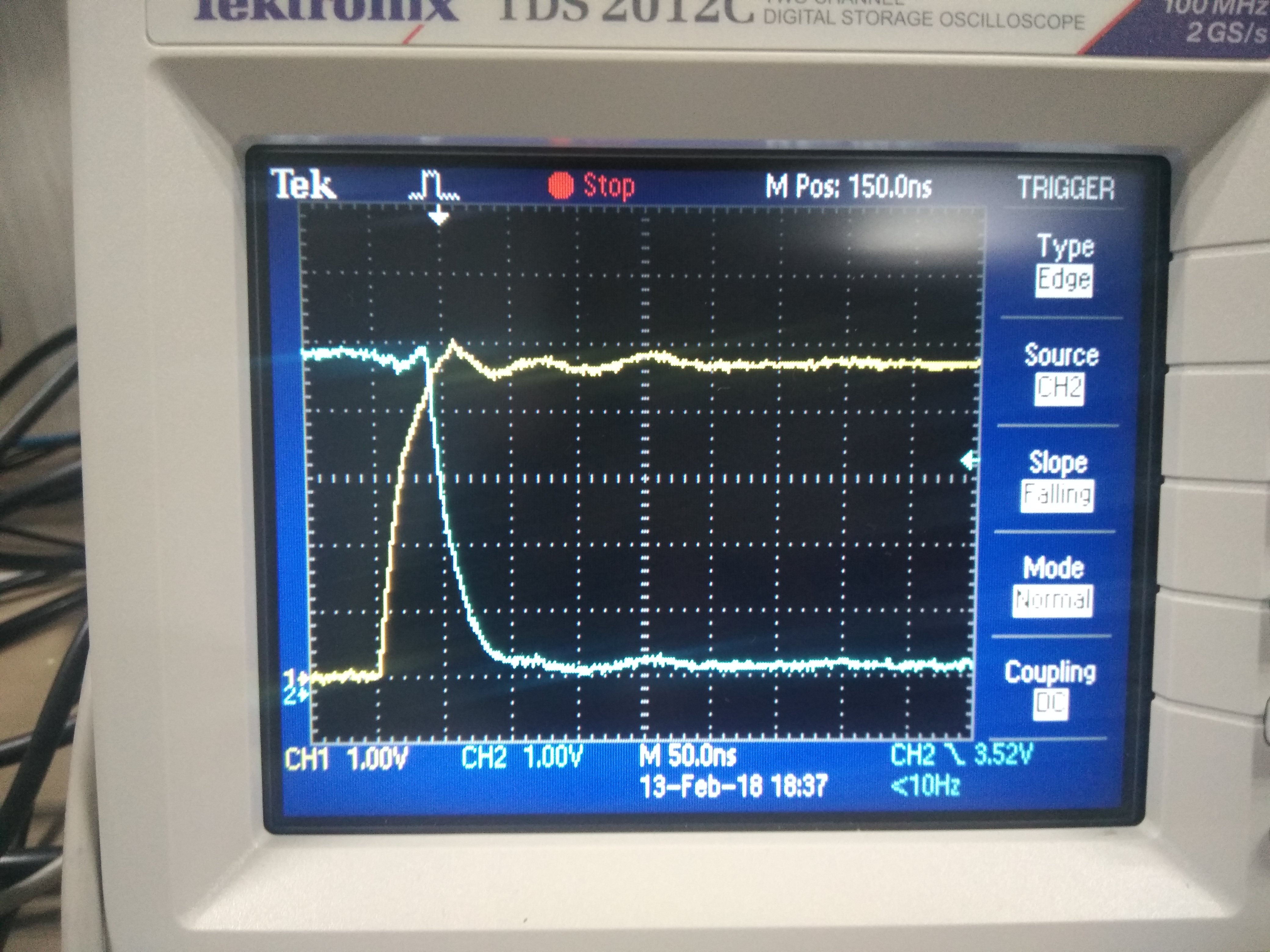

Please Refer the attached Waveform captured at pin 1MR & 1CP. Once MR become Low, the output Q0Q1Q2Q3 should be 0000 for first Falling Edge of Clock pulse as per Truth Table.
But why i am getting 1000? is anything misunderstood the Logic? Can anybody help me explain why?
