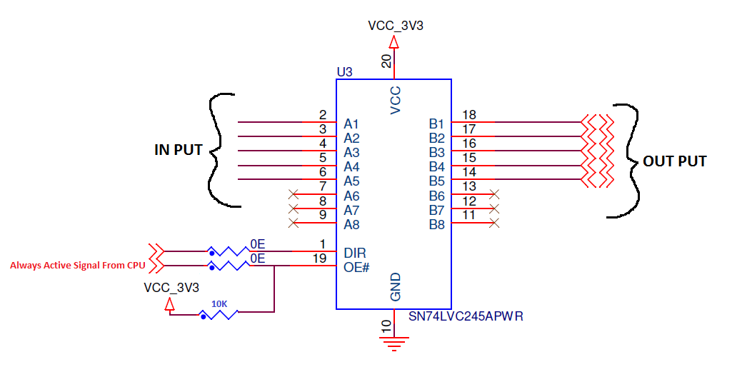

I'm using SN74LVC245APWR in my design. OE# (PIN 19) is always connected from one of the CPU active weak GPIO pin and it always drive even-though VCC (20th PIN) is powered OFF.
Is there any possible to back drive OE# pin if I connect the active GPIO before VCC (20th PIN) comes ?
Here I found one observation, OE# (PIN 19) driving low whenever VCC (20th PIN) is powered OFF. Is it expected observation ?
