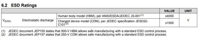

Dears:
From datasheet we can see the ESD Rating as below picture:
How could we know the value of ESD Protect under air and contact like the other device's description as below picture?
Thanks a lot!

Lian,
As Dylan said there is a difference between HBM, CDM and IEC 61000-4-2. A great blog that we put out will explain the differences
If you would like to protect your system from IEC 61000-4-2 ESD strikes you should add a discrete ESD diode.
