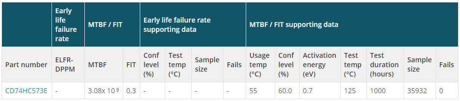

For reliability data, it's available through our website, located here:
I grabbed data for this part to make it easy on you:
