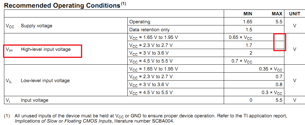

The SN74LVC1G08 Gate IC does not have a MAX input level in VIH, so please check the maximum VIH level.
1. in case of VCC is 1.8V
2. in case of VCC is 3.3V

    The maximum recommended input voltage is 5.5V, and the absolute maximum input voltage is 6.5V.
    You might be confusing VIH (high-level input voltage) with VT+ (positive-going input threshold).  These specs are very often confused, but are not the same.  The SN74LVC1G08 has standard CMOS inputs, and their thresholds will always be at approximately VCC/2.
  • I have been inquiring about tolerance allowed in Input when VCC is fixed.
    If 1.8 V is applied to VCC, check the maximum allowable value of IC input.
    VCC: 1.8V
    MIN: 0.65V x Vcc / MAX: ??
    VCC: 3.3V
    MIN: 2V / MAX: ??

    As I stated above, the maximum recommended input voltage is 5.5V. I did not specify a limit on Vcc because the two are not related.
