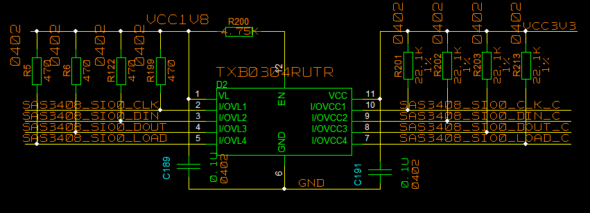

I know that TXB0304 datasheet shows it can only translate push-pull logic. But my customer adopt this device for open drain output and the board already manufactured. Schematic is as below. Need to translate left 1.8V(open darin) logic to right 3.3V logic. How to support this scenario? Or is there pin to pin solution to support this scenario? Thanks!
