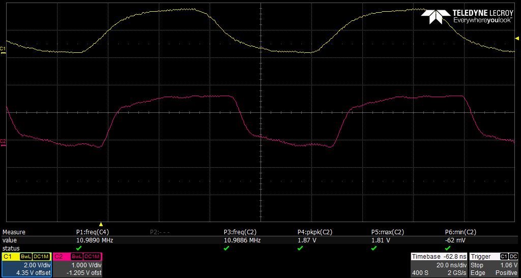

I'm using this part to receive a trigger that could have a slow rise time.  The intention is to use this part to provide clean rising and falling edges to the next IC in line.  I have a few questions though.
ch1. is the input
ch2. is the output
1.  Where do you find the rise/fall times (slew rate?) in this data sheet?  It doesn't seem to be listed.

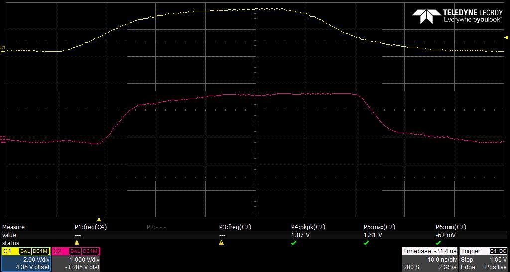

2.  I'm testing with this part now and the below screenshots of operation with a 1Mhz square wave input (3.3Vpp with Vcc = 3.3V) from a TEK sig gen raise some questions.
a. Why is the output so noisy?
b. The rise time seems to be ~10nS.  Does this make sense?  I'm trying to reconcile this with the data sheet.
3. Why does section 10.2 reference a (delta t)/(delta V)?   I cannot find this in the datasheet.
Note about schematics:  The part is implemented on a PCB with NO decoupling cap (this could be contributing to the noise seen in Ch2 (red)??).  There is no output cap and no input cap on the input/output pins.  This part is driving a clock input of another IC that does not list a spec for this pin's input capacitance.
fig1
fig2
    Can you describe your test setup? Or better yet, post a schematic of how it's setup?
    I know you say the Vcc is 3.3V here, but I see a 1.8V signal on the scope shots (pink signal is set it 1V/div and it's about 2 divisions high). If the supply were at 3.3V, you'd probably see much better edges from the LVC device.
    Without a lot of details, I couldn't really say.
    Yes, 10ns isn't so bad for a 1.8V supply at ~30pF load.
    That can definitely add noise.
  • I apologize - you are correct - this part is indeed powered from 1.8V. I will try to get you the schematics very soon. I guess i'm not really out of the ball park in general though with a 5 to 10nS rise time for this part.
