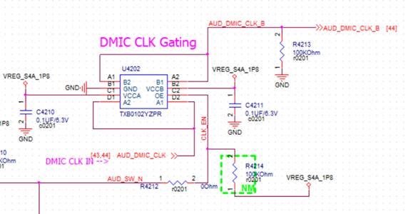

Currently, my customer faced a problem of TXB0101. They used TXB0101 to be the switch of DMIC's Clock.
From the clock output waveform below, it seems like TXB0101 doesn't have enough driving capability.
Do we have another solution or digital buffer that could meet their requirement?
I would be better if the solution has EN pin.
