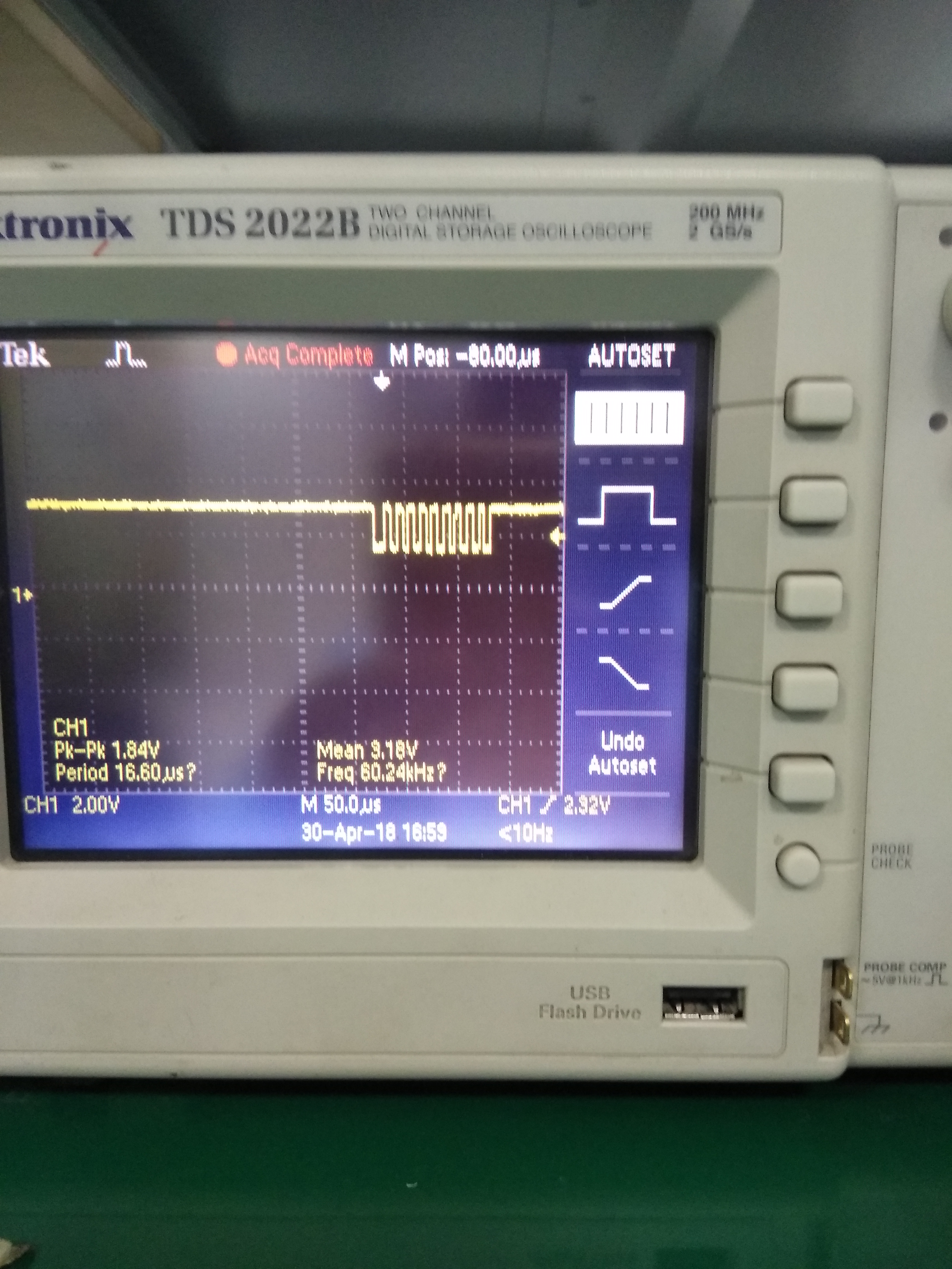

          Am using the TXB0302 part for I2C level translating purpuse(VCCA - 1.8V to VCCB - 3.3 V).
But My I2C is Failing, because this TXB0302 output  logic 0 is shifted above 1V, My slave wont accept the Logic above 0.5V.
The TXB0302 Data sheet doesn't mentioned about this shift. Here with I have attached the screenshot for your reference. Kindly suggest me any possible way to short out this issue.

  • Hi Venkatesh,
    TXB0302 is not suitable for I2C level translation since the interface is open-drain and TXB is buffered device with internal 1k limiting resistor which will form a voltage divider with the external pull-up you have for the interface.
    Please consider switching to TXS0102 for I2C level shifting and let me know if you have any issues.
