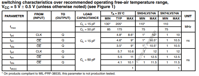

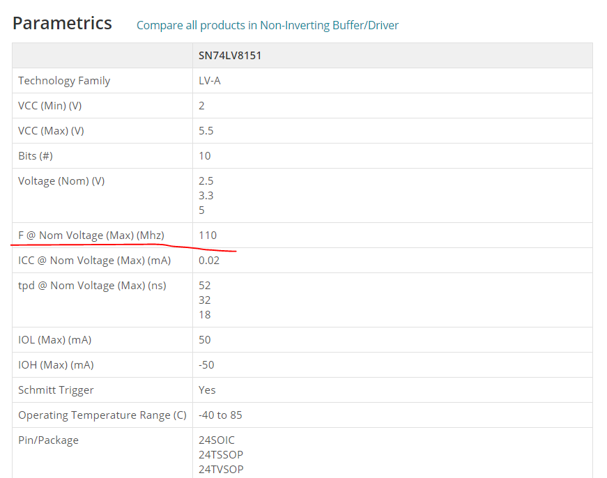

Hi Dears,
The maximum tpd of this device is 15 ns at 5 V, but the description of max frequency of this device is 110MHz. It is correct or not? The propagation delay will influence the max frequency. In my opinion, f<1/15ns=66.7MHz, it is right?
Any comments or suggestions are welcome.
