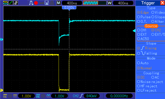

I'm seeing some strange behaviour on the TXB0108RGYR. Setup:
1. GND (pin 11) and PAD are connected to GND.
2. VCCA is 1.8V.
3. VCCB is 3.3V.
4. A 3.3V output is connected to B1 (pin 20 - CH1). A 1.8V input is connected to A1 (pin 1 - CH2).
As you can see, the 1.8V output is not clean. The enable is at 3.3V for the entire pulse.
For anyone interested: the TXB does not actively hold outputs at 0 or 1. Only the edges are accelerated through one-shots. The input above has a pullup, and it contends with the TXB's pulldown at logic level 0. The TSX0108E has a Npass FET that connects the input to the output at logic level 0, and provides a much cleaner output (low-output is around 60mV).
Hello Inderjit,
I'm sorry I was not able to reply to your earlier post sooner, but it looks like you were able to come to the recommended solution.
For applications that require pull-up resistors - the TXS0108E is the best choice.
It is not recommended that you use TXB translators with pull-up or pull-down resistors, unless they are at least 50kOhm.
The TXB device does have a weak drive (4kOhm) that will hold the output at 0 or 1. However, if you have a pull-up, (in this case it looks like ~15kOhm?), it will contend with the internal TXB buffer, and exhibit the behavior you show in your scope capture.
I've included a link below to an applications note that details using TXB translators.
