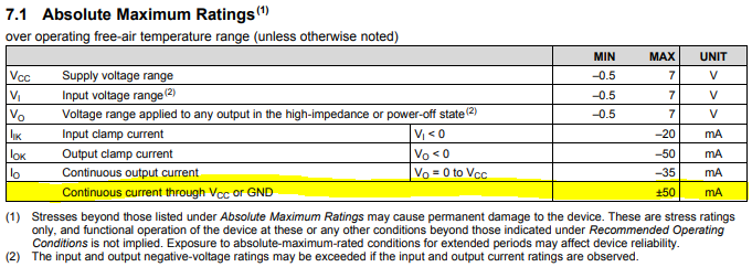

The maximum output current is clearly stated in the Absolute Maximum Ratings table.
That's 50mA total for the device (since it only has 1 ground pin) and 35mA max per pin.
Your power consumption calculation is correct for DC, however if you are using the datasheet's VOL values, you are calculating the absolute worst case rather than the typical power consumption.
For this device, assuming an even split of current (35/8 = 4.375mA) and 5V operation, we can expect to see power consumption of 8*( 0.004375 * (0.55V*4mA/16mA) ) = 4.8125 mW. This gives an expected temperature increase of 0.0041825 * 0.484 C (in the D package). In other words - if operated within datasheet specs, the device shouldn't heat up.
***** Correction *****
I accidentally used the 35 mA instead of 50 mA in my calculation. 50mA / 8 = 6.25mA, new Vol(max) = 0.55V * 6.25mA/16mA = 0.21484V.
This gives an updated power consumption of 10.742 mW and a temp increase of 1.08 C. Sorry about that.
